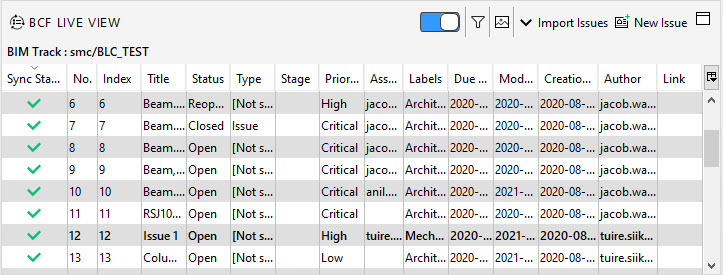

The BCF Live view shows the issues synchronized with the issue management platform. Once you have turned on the synchronization, the sync button appears as blue and the view is populated with issues. The name of the current project is shown above the table. The synchronization status is shown in the leftmost column. When the synchronization is ongoing, the status icon is . When the synchronization is complete, the icon is

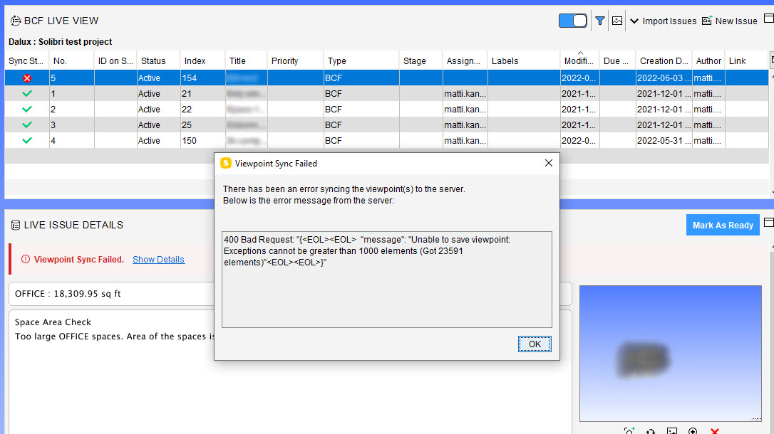

If there's a problem with synchronizing the issue to the server, the icon will be shown in the live issue list. These problems include, for example:
Missing issue title
Server timeout
Connection error
Other limitation on the BCF server side (for example, a limitation on the number of components included in a viewpoint)
Note
From version 9.12.10 onward, Solibri will display a warning when a viewpoint sync error is detected. When an issue has been updated, the row is highlighted using bold text:

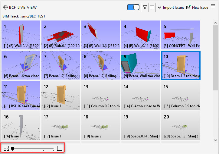

You can view the issues as a list or as thumbnails. To switch between the two modes, click /
in the view toolbar:
In the thumbnail view, you can change the size of the thumbnail images using the slider:
Issue title and index number are shown at the bottom of each thumbnail image.

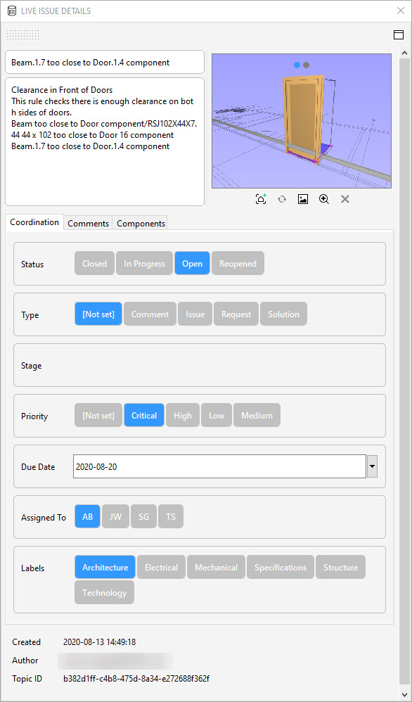

When you select an issue in the BCF Live view, you can view and edit the issue details in the Live Issue Details view:

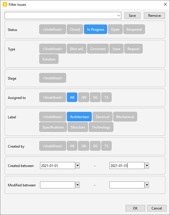

To filter the issues in the BCF Live view, click . The Filter Issues dialog opens:
When you activate a filter, it turns from grey to blue. You can select one or multiple filters. You can filter the issues by status, type, stage, assignment, label and creator.
If the Assigned to filter has a long list of assignees, a search field appears and you can search for a specific assignee.
Click OK. The filter icon turns blue to indicate that the list of issues has been filtered. Note that until you select another issue from the filtered list, the filtered view will automatically show the current selected issue even if it does not make the criteria.
