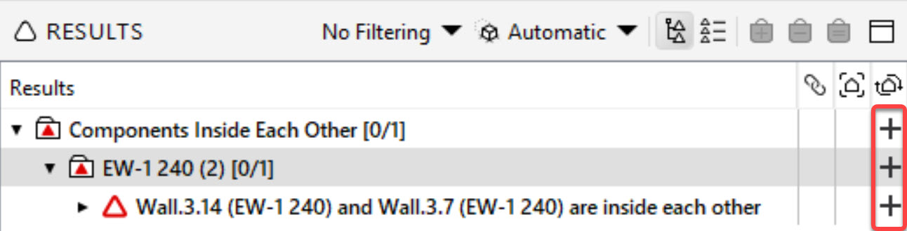

Select a rule with results.
In the Results view, there is a column for importing the issue to the server:
Double click

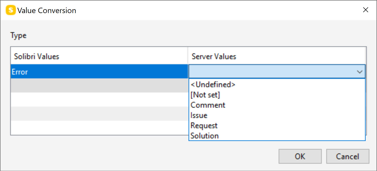

A Value Conversion dialog opens, and you need to match the Solibri values with the server ones. The server values depend on the server Solibri is connected to. Select the matching server value from the drop-down menu and click OK:

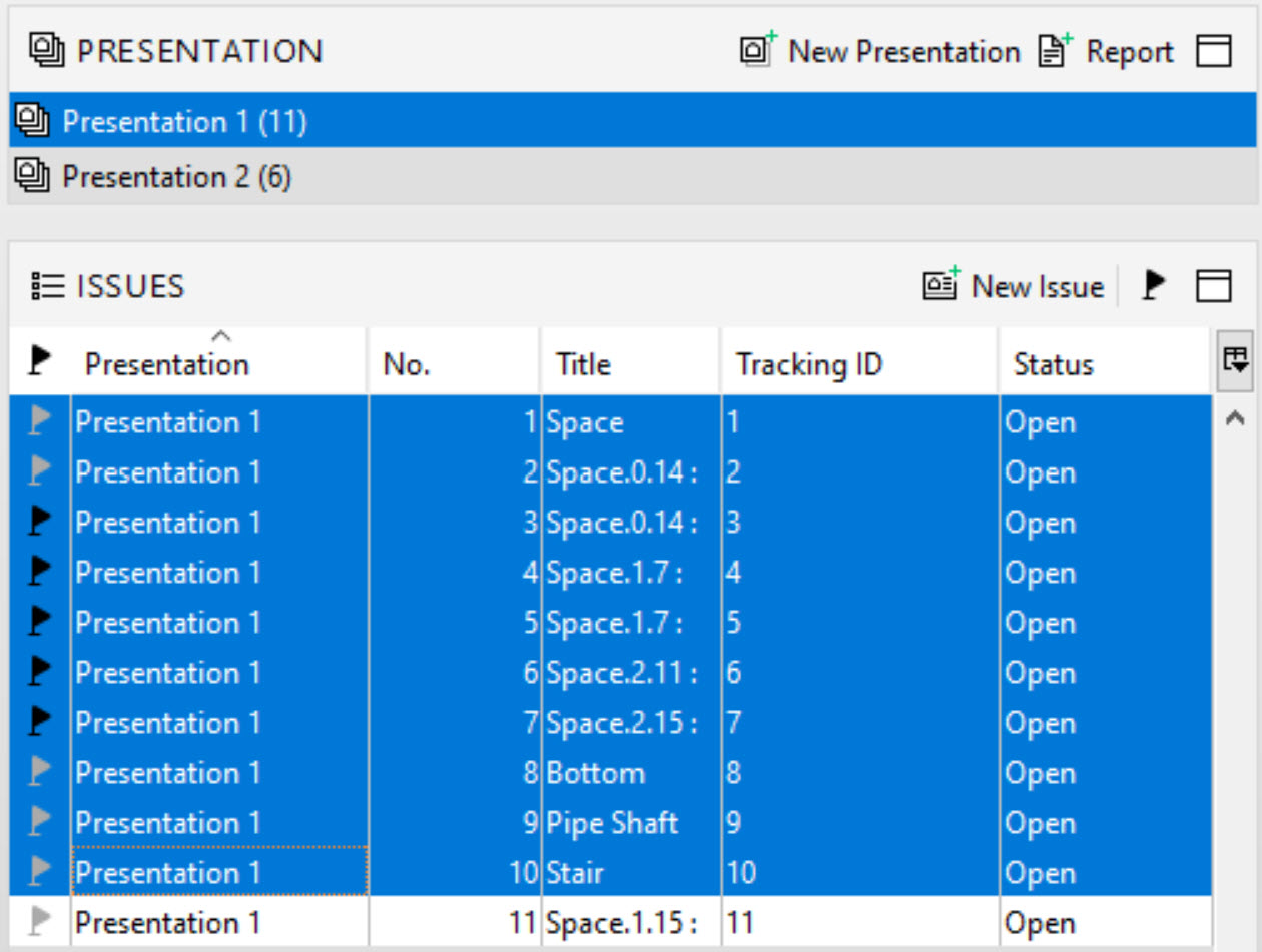

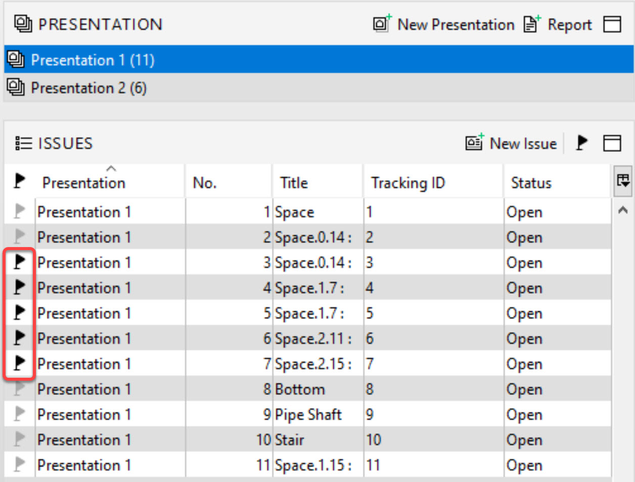

When you have created a presentation with issues in it, you can import those issues from the presentation to the BCF Live session. To import issues from a presentation:

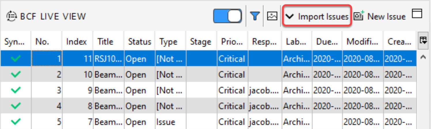

Click Import Issues in the BCF Live view:

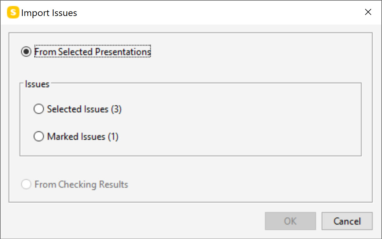

Select From Selected Presentations and then either of the two options, explained below the image:
Click OK.

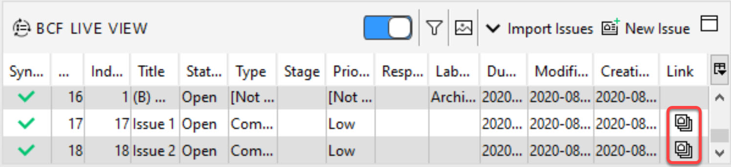

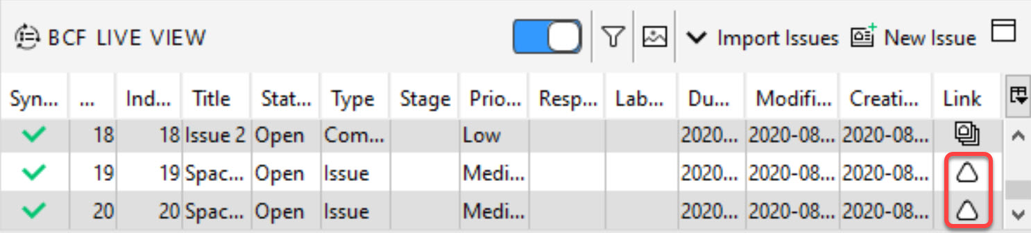

Issues which originate from Solibri and are related to checking results have the icon
in the Link column:
Issues which originate from Solibri but are not related to checking results have the icon
in the Link column:

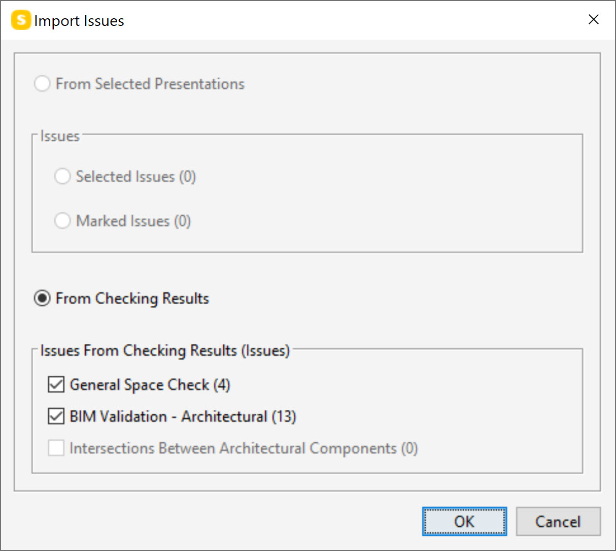

When you have a checked model open, and you have added at least one slide to an issue or an issue category, you can import issues from checking results to the server.
Please note that when you re-import checking results issues you have previously imported, the server values (and thus any changes made on the server side) will be overridden.
To import issues from checking results:
Select From Checking Results and select the results you wish to include:
Click OK.
in the Link column:
