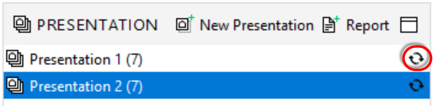

Right click the presentation in the Presentation view and select Synchronize Presentation from the context menu.
Tip
To synchronise using the synchronisation settings you have previously saved, click
You can then go directly to step 5.

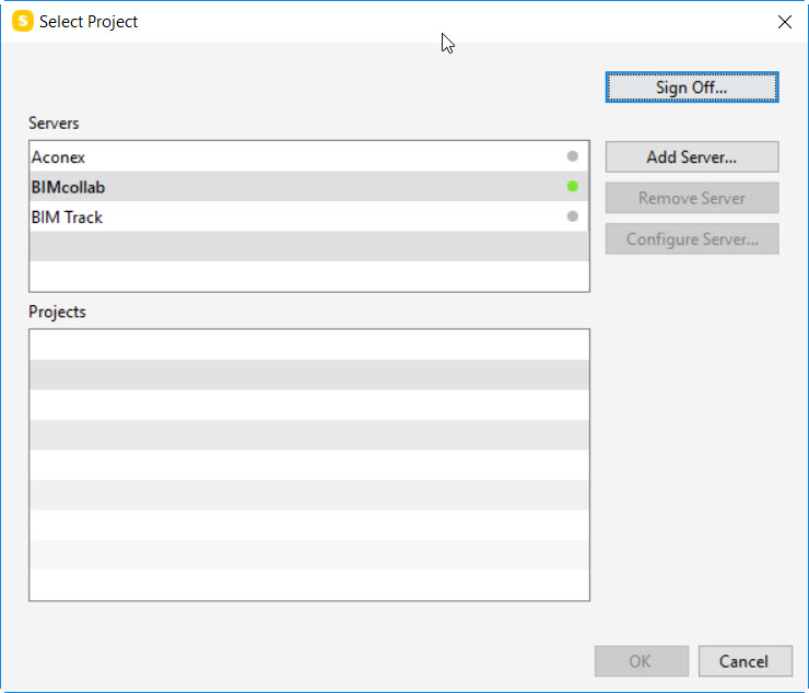

If you already have a project selected, go directly to step 3. If no project has been selected, a dialog opens. Select a server and a project from the list and click OK:
Note
For instructions on how to connect to a BCF server, see About BCF Connector.

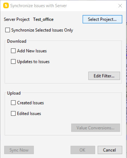

A dialog opens. Select the actions you wish to take:
Tip
If you need to select a different project for synchronisation, click Select Project.
To synchronise only the selected issues, mark the Synchronize Selected Issues Only checkbox.
Download:
To import edited slides from the BCF server, mark the Add New Issues checkbox.
To update the edited issues from the BCF server, mark the Updates to Issues checkbox.
To edit the filters before you continue, click Edit Filter.
Upload:
To upload new slides to the BCF server, mark the Created Issues checkbox.
To upload changes in the slides to the BCF server, mark the Edited Issues checkbox.
To edit the value conversions before you continue, click Value Conversions.

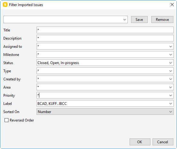

If you're importing new issues from the server, a filtering dialog opens. You can filter the imported issues by adding filters. The default value * matches 'any' in the property field. You can add multiple filters by entering them manually. Select the filtering you wish to use and click OK. Note that If you add multiple filters, note that only the issues that match ALL the filters are imported.
Tip
To save the filtering you have made, enter a name to it and click Save. The filtering is now available in the drop-down menu for further use.

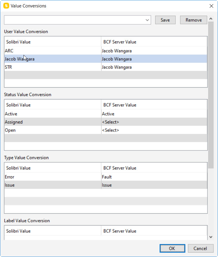

If there are any conversions which have not been set, a value conversion dialog opens. Map the values between the BCF server and Solibri. Click OK.
Tip
To save the mapping you have made, enter a name for it and click Save. The mapping is now available in the drop-down menu for further use.

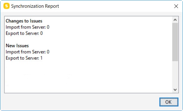

The presentation is now synchronised. When it's done, a synchronisation report opens. To close the report, click OK:
