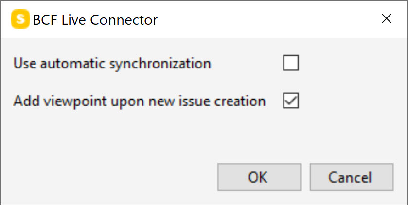

Click File, then Settings, then BCF Live Connector.
A dialog opens. Unmark the Use Automatic Synchronization checkbox and click OK:

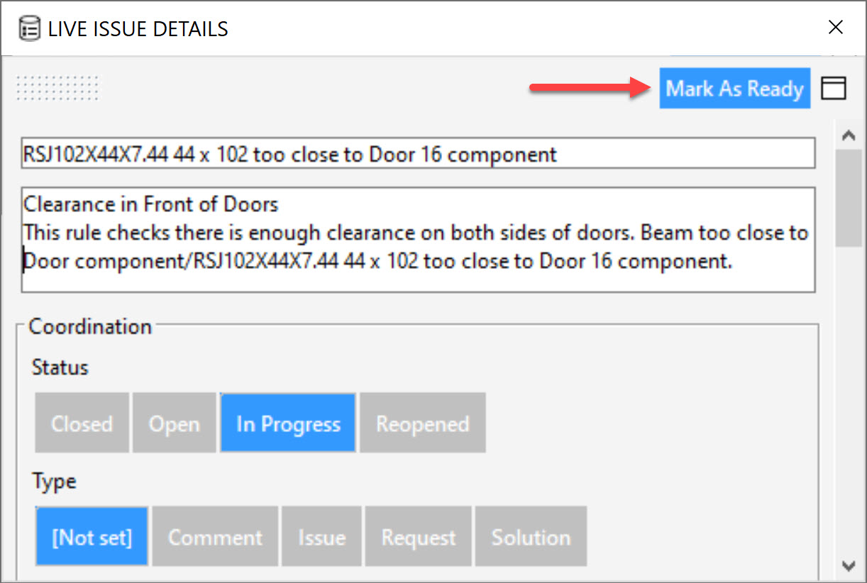

When you now select an issue in the BCF Live view, the Live Issue Details view has a Mark As Ready button. If you edit the issue details, the button turns blue:
When you are ready with the changes in the issue details, click Mark As Ready and the changes are synchronised with the server.

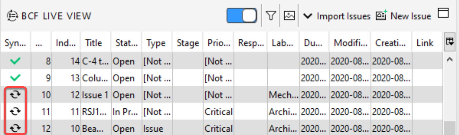

You can also edit issues and leave them waiting for synchronisation while moving from one issue to another. The symbol in the Sync Status column indicates that the issues have not been synchronised:

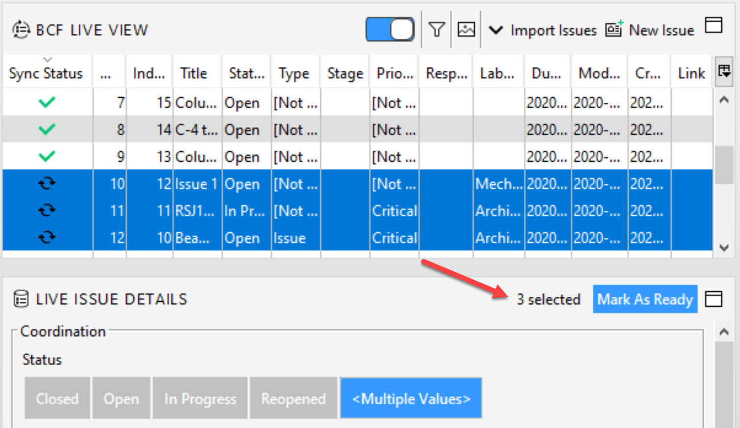

You can use multi-select to select all the issues and then click Mark As Ready. You can see the number of issues you have selected in the Live issue Details view:
All the selected issues will then be synchronised with the server.
