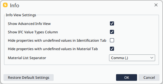

In the Info settings, you can control the settings for the Info view. To access the settings, click File > Settings > Info.
Restore Default Settings
To restore the settings in this dialog to their default values, click the Restore Default Settings button and confirm your action. This will affect the settings in the dialog. Please note that this action cannot be undone.
You can select to use the Advanced Info view or show or hide the IFC Value Types column. This settings option is available in v9.13.4 and newer. By default, both options are on. To learn more about the Info tool and view, see here.
Show Advanced Info View:
When selected, the Info view structure will have three main tabs: BIM Data, IFC Standard Properties, IFC Standard Quantities, Other Properties, and Custom. Each tab has additional tabs under it. This advanced view offers a more concise and user-friendly structuring of the data in the Info view.

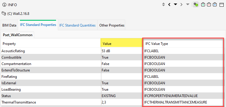

Show IFC Value Types Column:
When selected, the IFC Value Types column will be shown next to the Value column in the Info view:
The IFC Value Types column displays the type of data being used (INT, CHAR, BOOLEAN, DATE, etc.), so you can easily identify the type of data being used and ensure that it is correct.
Hide properties with undefined values in Identification Tab:
When selected, properties without defined values are hidden in the Identification tab in the Info view.
Hide properties with undefined values in Material Tab:
When selected, properties without defined values are hidden in the Material tab in the Info view.
Material List Separator:
Defines the separator used for listing multiple materials (for example, comma, period, semicolon) in the Material tab.
