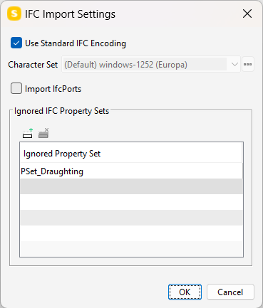

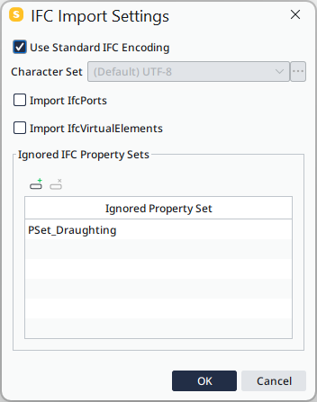

The IFC import Settings are provided by Solibri, but you can change them if needed. To access the settings, click File > Settings > IFC Import.
Use Standard IFC Encoding: When selected, the custom IFC character set is ignored, and the standard IFC encoding is used instead (equivalent to UTF-8).
Character set:
The character set that is used to decode information in IFC files.
If you receive IFC files in a different language or operating system, change the character set. Click
, select the character list and click OK:
Import IfcPorts: When selected, IfcPorts are imported. This setting is available in v9.13.8 and later. Note that if you save a project with the ports are imported, it's incompatible with older versions of Solibri. By default, this setting is turned off.
Import IfcVirtualElements: When selected, IfcVirtualElements are imported. This setting is available in version 26.3 and later. Note that if you save a project with VirtualElements imported, it will be incompatible with older Solibri versions. By default, this setting is turned off.
Ignored IFC Property Sets:
You can list the IFC property sets you wish to be ignored. By default, the PSet_Draughting set (draft lines) is not imported.
To add a row, click
. To rename property set, double-click the row.
