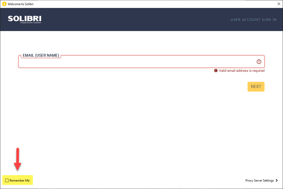

Important
If you're using a proxy server, mark the Remember Me checkbox when you log in. Otherwise, you will lose the proxy settings you have configured. You can change the setting later in General Settings.

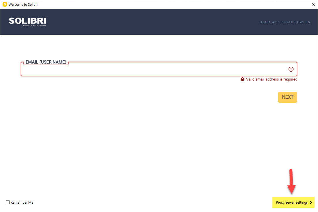

If you wish to configure the proxy server settings in the user interface, the quickest way to access them is clicking Proxy Server Settings in the Solibri login window:
You can also access the settings later by clicking File > Settings > Proxy Server.

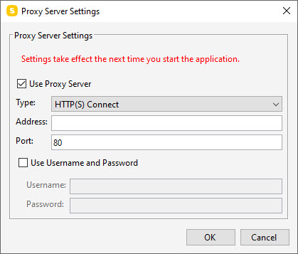

The Proxy Server Settings dialog opens:
Mark the Use Proxy Server checkbox.
Select the proxy server type from the drop-down menu.
Insert the address and port.
If your proxy needs username and password, mark the Use Username and Passwords checkbox and insert username and password.
Click OK. The proxy details you have specified are stored in the registry.
If you're using Solibri for the first time, Solibri should now launch and you can login with your credentials. Otherwise for the settings to take effect, restart Solibri.
