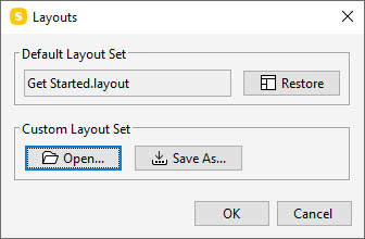

In Layouts Settings, you can manage the user interface configuration of Solibri. By default, Solibri has five layouts in addition to the File layout, but you can also create your own layouts and add views to them.
The layout settings allow you to apply (=restore) a default or saved layout configuration. Any changes made to your configuration can also be saved from this dialog.
A saved layout set stores the layouts available (Layout bar) and the views that are loaded, as well as their on-screen size and positions. You can save the current set of layouts as a custom layout set.
To access the settings, click File, then Settings, then Layouts.
If a role has a default layout set in the Roles panel, the Default Layout Set field shows the name of that layout set. Otherwise, Solibri's default layout set is used.
To restore the changes you have made to the current layout set:
To open an existing custom layout set:
To save the current layout as a custom layout:
