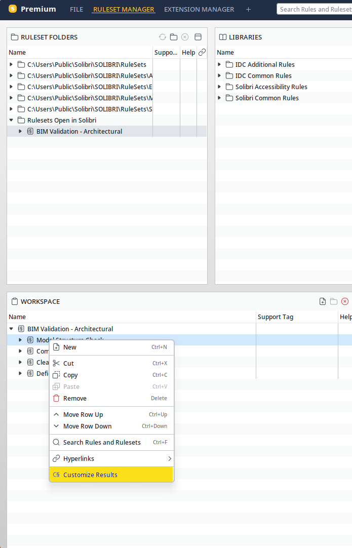

From Ruleset Manager
Open File → Ruleset Manager.
In the Workspace view, right-click the ruleset or rule you want to customize.
Click Customize Results.

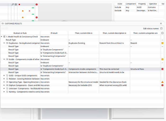

Select the row for the results you want to customize:
Has errors: Apply a default customization to all results
Result Type: Customize a specific result type only

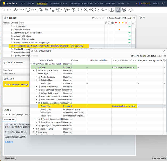

Irrelevant: Customize the description for irrelevant rules

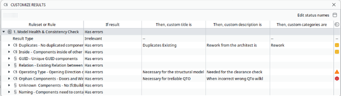

Fill in one or more of these fields:
Then, custom title is
Then, custom description is
Then, Custom categories: Double-click to edit the list of categories, from parent to children. After editing, the category levels are shown inline separated by an arrow (e.g., Fire Safety → Exits)
Status: Choose OK, Info, Alert, or Error

How the rows work
The selected row determines which results are affected.
A customization at the ruleset level applies to all rules in that ruleset unless a more specific customization overrides it.
A customization at the rule level applies only to that rule.
A customization at the Result Type level applies only to that result type for that rule.
More specific customizations always take priority over more general ones.
For example, if you add a custom title at the ruleset level and then add another custom title for one specific rule, the rule-specific title is shown in results from that rule, while the ruleset level title is shown in results from all other rules in the ruleset that are not customized.
Irrelevant results
The Irrelevant row is used differently from Has errors rows.
For irrelevant results:
You can customize the message shown for the irrelevant result in the results area.
You cannot customize the title or categories for irrelevant results.
This is useful when you want to replace the default irrelevant message with a clearer project-specific explanation.

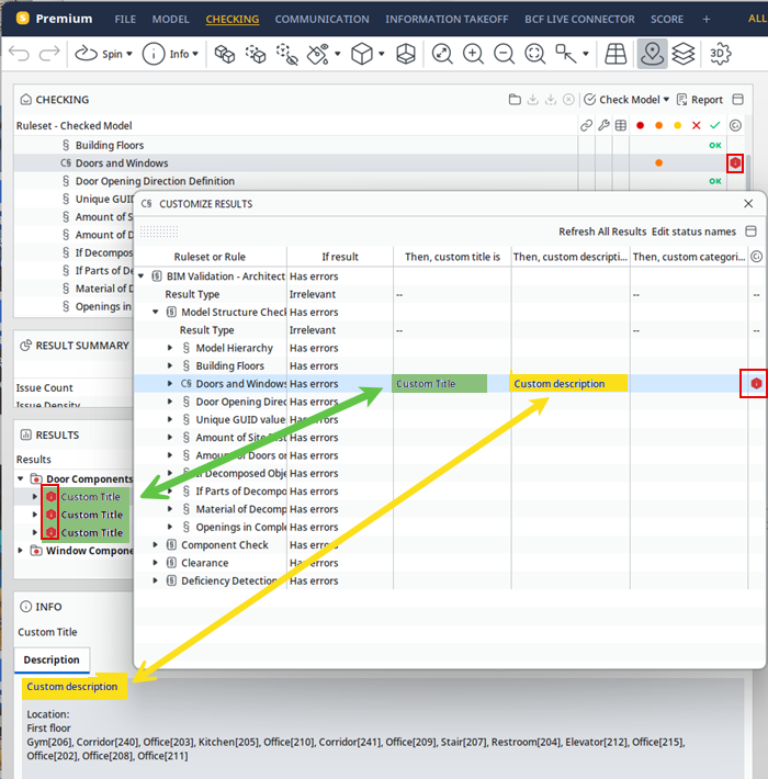

Titles and Descriptions
Custom titles and descriptions are used in different ways:
The custom title is the short text shown in the results list.
The custom description can contain more detailed information and can be multiline.
After editing, the custom description is shown in the Info view when the result is selected.
This allows you to keep the result title short while giving users more context in the description.

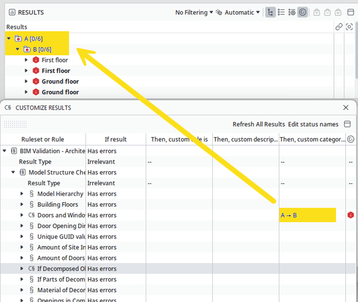

Custom Categories
You can use Then, custom categories are to place results into project-specific categories instead of relying only on the categories defined by the rule. Double-click the cell to open the editor for custom categories. Use the add, remove and reorder buttons in the toolbar of the custom categories editor to insert, delete and reorder categories. Double-click on an existing category in the list to edit its name.
When entering categories:
Arrange the categories in the desired order. The results will be arranged in nested folders according to the specified order, from top (parent category) to bottom (child category).
A category defined at the ruleset level applies to all results in that ruleset unless a more specific rule or result customization row is found. Note that a more specific row defining only a custom title but empty custom categories will still count as a full customization, replacing the ruleset level categories with the default one for that specific rules.
A category defined on a specific rule or result type applies only there.
This is useful when you want results to appear under clearer or more project-relevant groupings.
