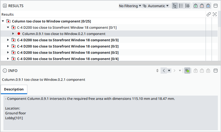

When you click a result at the issue level, you can see a description of the issue in the Info view:

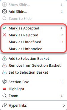

Right click the result in the Results view. Select one of the options from the context menu:
Tip
You can also use the keyboard shortcuts (Shift + A/R/U).

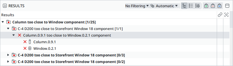

The symbol before the result changes according to your decision:
