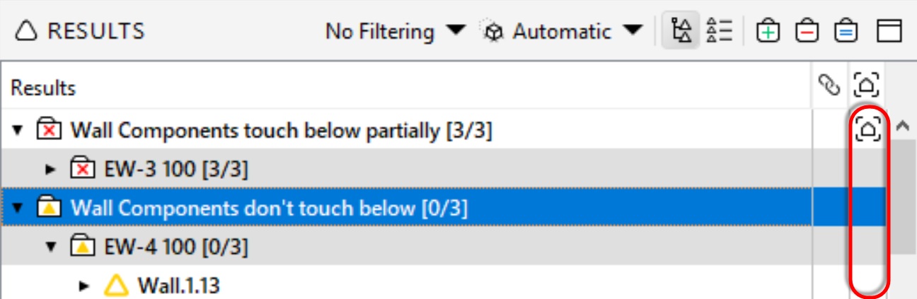

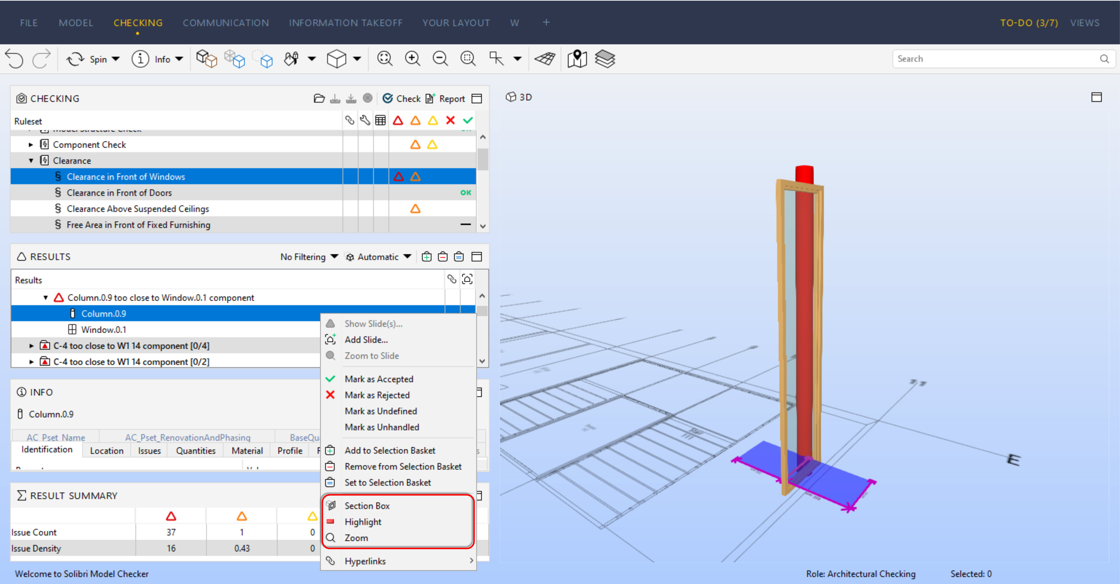

Right-click a category, individual issue or a component in the Results view and select Add Slide from the context menu. Alternatively, double click the cell in the slide column:

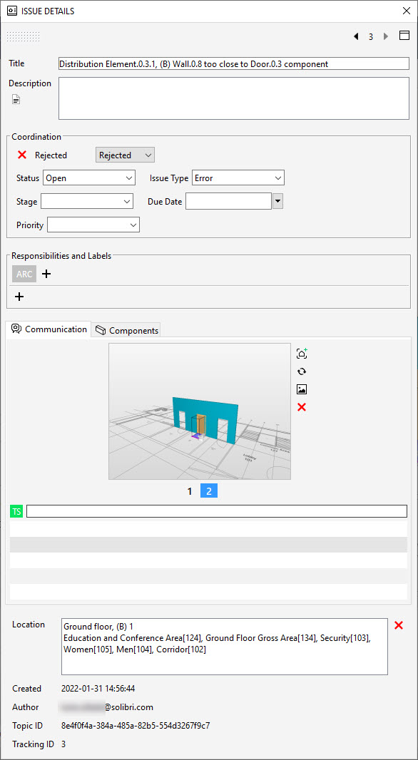

The Issue Details view opens, showing the details of one issue slide:
By default, the title is the same as the title of the category, issue or component you selected. For more information on how to edit issue details, see Editing Issue Details.

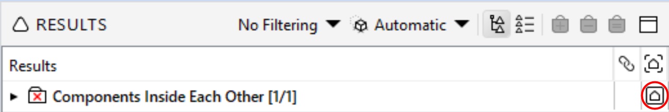

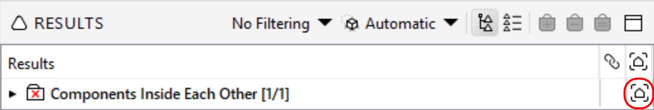

When you have added a slide to an issue, an icon appears in the Results view:
Note
Adding slides to issues doesn't automatically add them to a presentation. To add the issue slide to a presentation, you need to create a presentation from checking results.
After the slide has been added to a presentation, the icon in the Results view changes from to

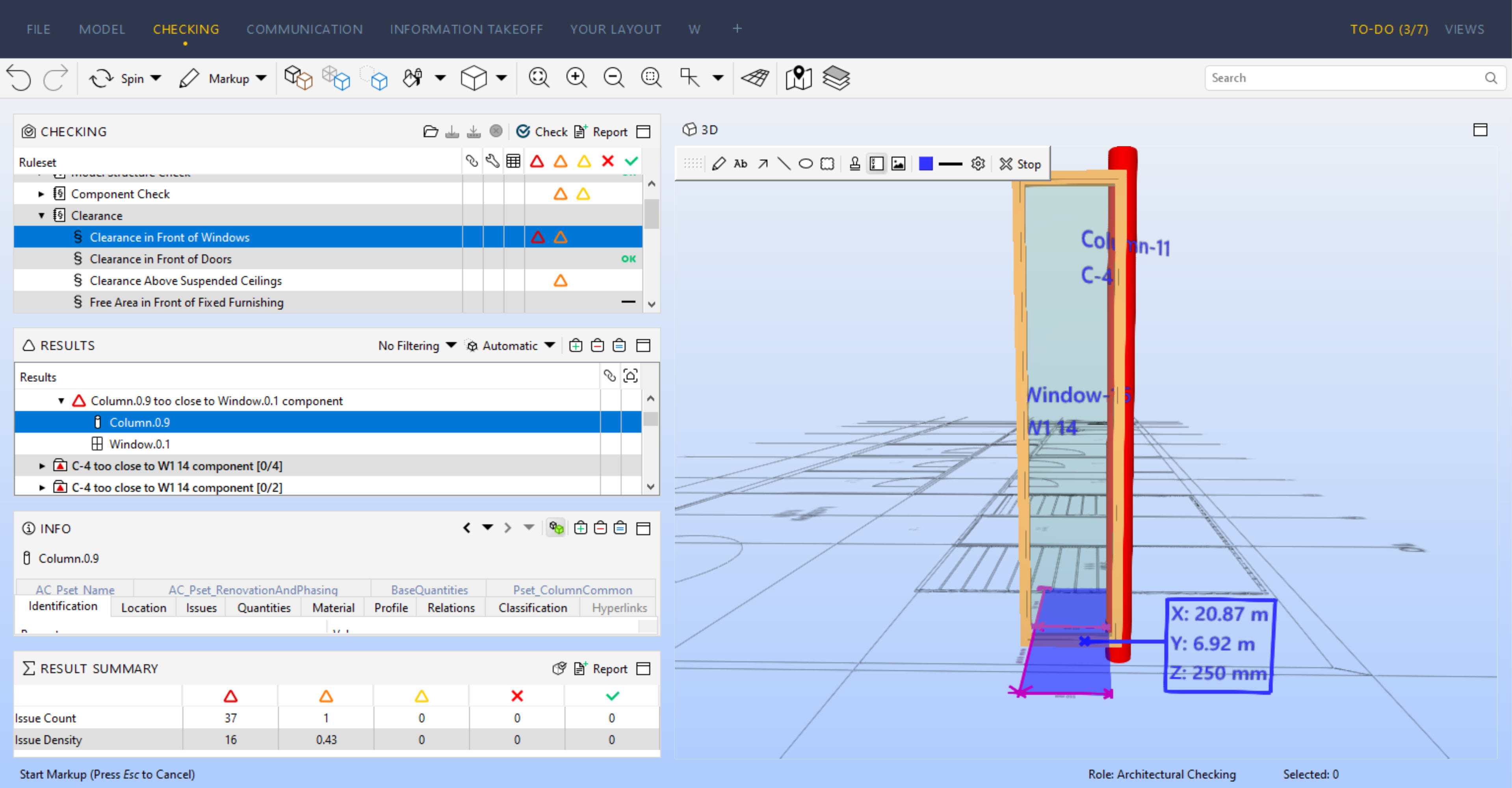

You can make issue slides more informative by using visualisation tools. You can, for example, add a section box, highlight components and zoom into them:
You can also add markups and dimensions to the model (these are only saved in the slides):
