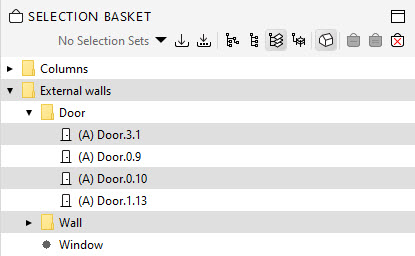

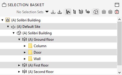

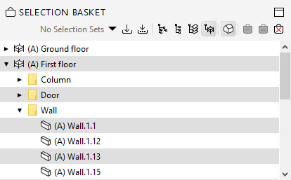

You can view and manage the selected components in the Selection Basket view. By default, the Selection Basket view is located in the Information Takeoff layout. You can add the view to any layout from the Views list (upper right corner of the UI).

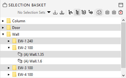

In the Selection Basket view, you can see and browse the selection basket content in similar hierarchies as in the Model Tree view:
Containment (
Component (
Layer (
Federated floors (

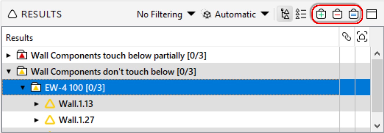

In addition to the Selection Basket view, you can add components to the Selection Basket from other views such as the Model Tree, Info, Results and Information Takeoff view, by using the Selection Basket tools in the view toolbar:

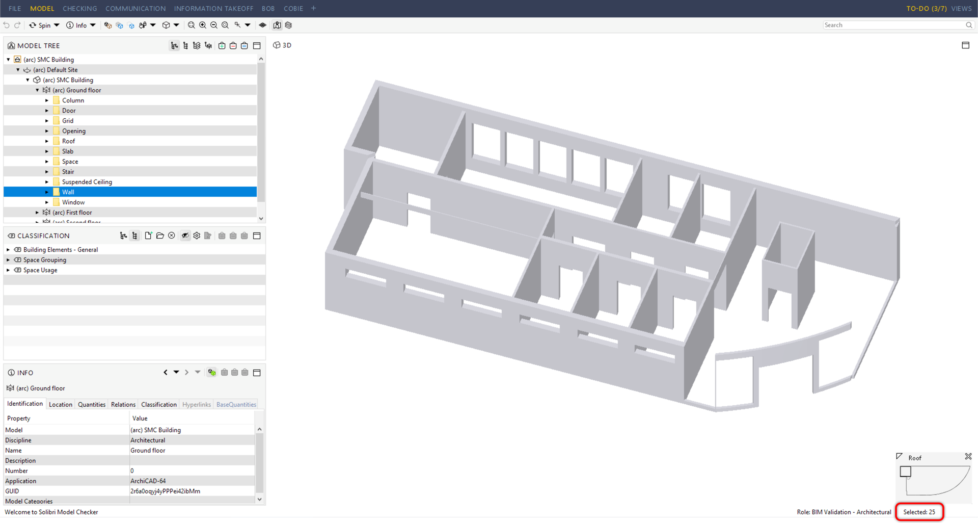

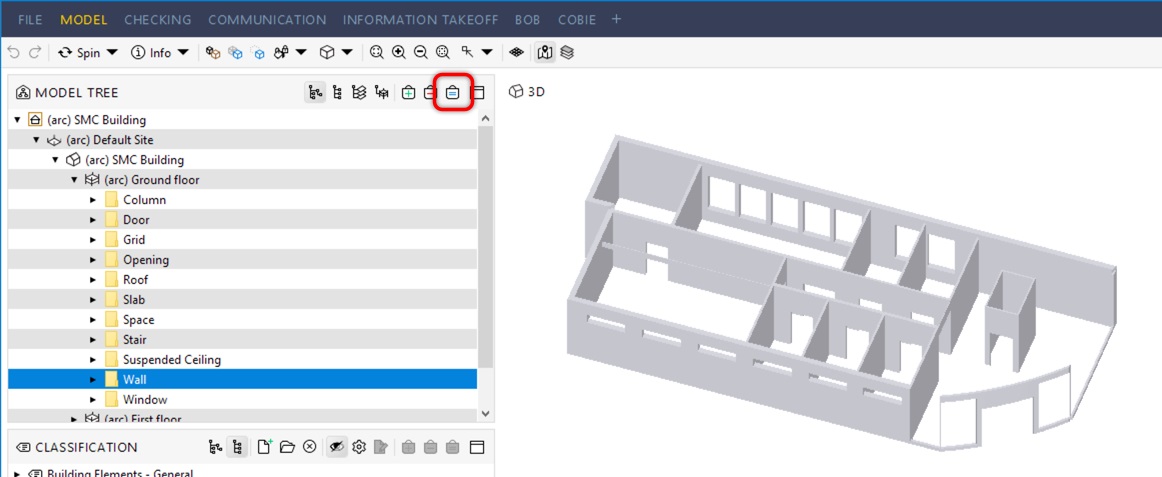

In the example below, the Model Tree view has been used to drop down to the ground floor and the wall components folder has been highlighted. This can be set using the function:
You can check if components have been added to the Selection Basket from the Status Bar. The lower right corner will show Selected: X where X is the number of components currently in the Selection Basket. In the example below, the ground floor walls have been selected and are visible in the 3D view, while the Status Bar in lower right corner (highlighted) shows there are 25 components:
