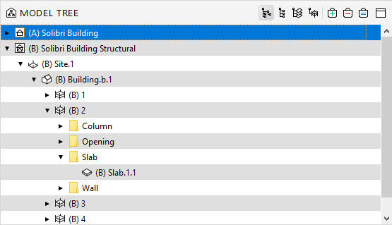

In the Containment Hierarchy(), components are organised by their construction types in the class hierarchy (following the IFC schema: file, site, building, floors, components).

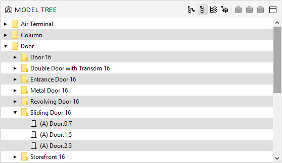

In the Component Hierarchy (), components are organised by IFC component types (following the components in the building, component and type).

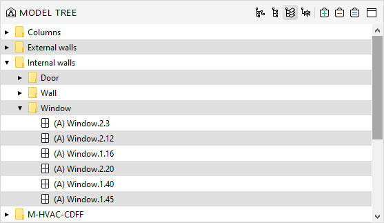

In the Layer Hierarchy (), components are organized by the layers exported from the authoring tool (in the case of Revit, the Family Names are used). Layer hierarchy is based on layers that have been created in the authoring applications.

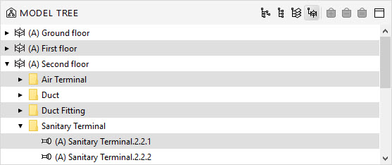

In the Federated Floor Hierarchy (), logical restructuring of components from different models into a singe floor structure. Models where the global level of the floors overlap will be evaluated and components are shown on the appropriate federated level. This is a special relation created by Solibri and it doesn't affect IFC relations.
