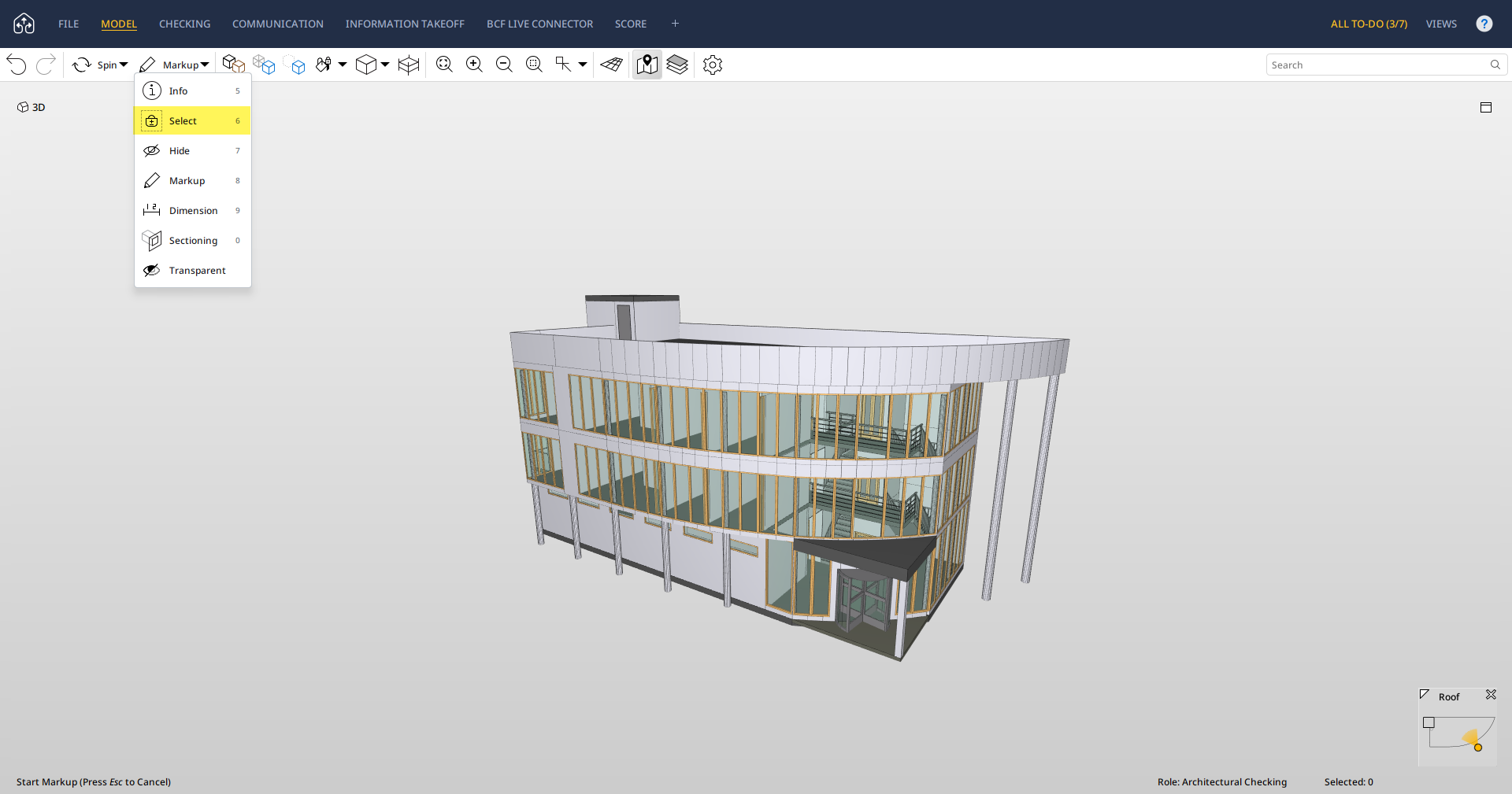

Select the Select tool from the main toolbar.

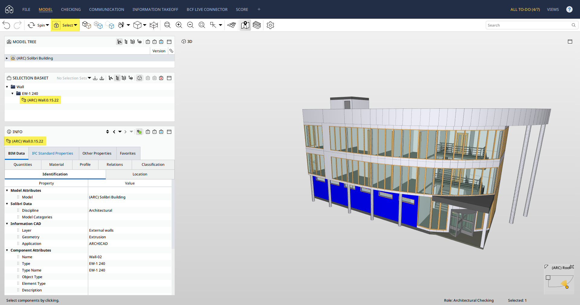

Click a component in the 3D view. The component turns blue to indicate it's now part of the current Selection Basket:
To add more components or to select multiple components at the same time, press Ctrl (Windows) or Cmd (macOS) and click the component.
To remove components from the Selection Basket, press Ctrl/Cmd and click.
If the component is part of the selection, it will be removed and turn from blue back to its default color.
If the component you have clicked on is not part of the selection, it will be added and turns blue.

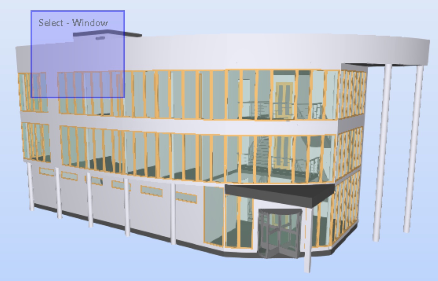

Window: Move the mouse from left to right to invoke the 'window' selection method, where all components must be fully inside the rectangle to be selected.

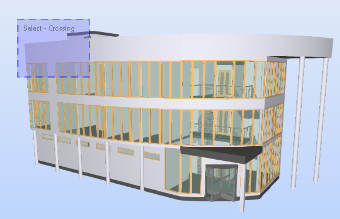

Crossing: Move the mouse from right to left to invoke the 'crossing' selection method, where all components can be inside or touching the rectangle to be selected.
