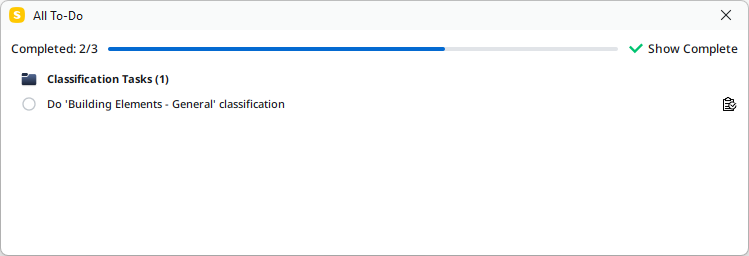

This article describes how you can add tasks to rulesets in Ruleset Manager. You can add two types of tasks, Generic tasks and User Input tasks. The tasks appear on a To-Do List, which opens automatically if you open a ruleset which includes tasks. You're prompted to complete the tasks before proceeding to checking. Some task are added automatically on the list - for example, a Classification task is added automatically, if a rule included in the ruleset is associated with a classification.

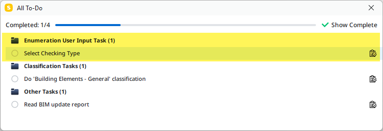

A Generic task is a general notification or reminder to execute a task like before checking. On the To-Do List, Generic tasks are listed under Other Tasks:

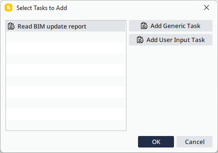

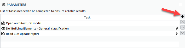

To add a new task, click
in the Parameters view:

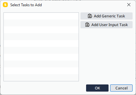

Select Add Generic Task:

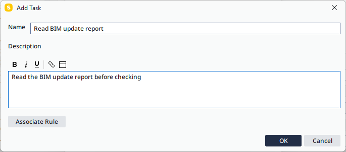

Insert a name and a description for the task:

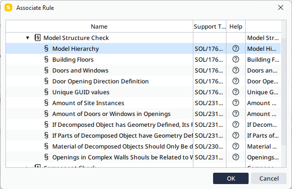

Associating a Rule (optional): If you wish, you can associate the task to a specific rule to, for example. guide the user to validate that the correct information is used before proceeding to checking. To do this, click Associate Rule. Select the rule and click OK:
To add the task, click OK:

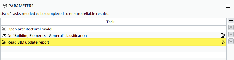

The task is now added in the list of tasks in the Parameters view:

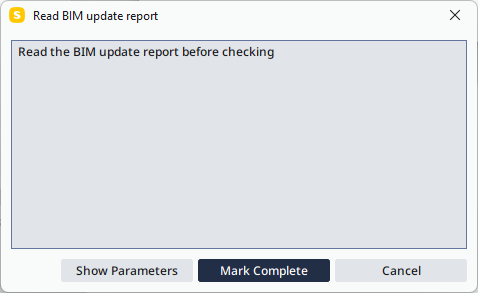

When you open the task from the To-Do List and click Show Parameters, the parameters of the associated rule will open. When you've completed the task, you can mark the task as complete.

On the To-Do list, User Input tasks are listed under Enumeration User Input Tasks:
The User Input task in commonly used as a gatekeeper rule, when the selected value launches specific rule or ruleset to be checked.

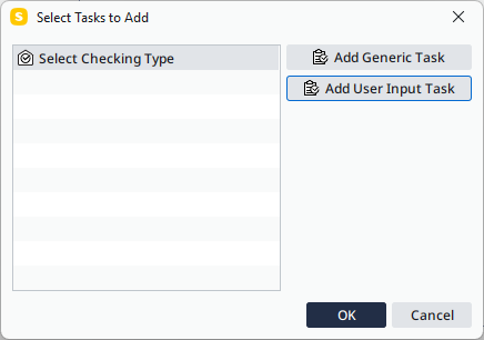

Select Add User Input Task:

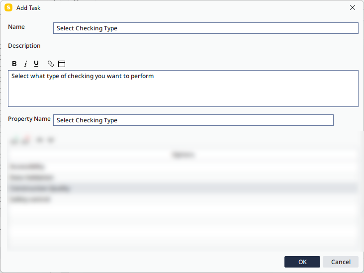

Insert a Property Name. The property can be any value from the IFC content. Typically, it's a building type, a construction or design phase, an area or a block of the larger or construction development. The name will be listed in the selection of User Input options in the Property column of the Requirements.
Add value options to the Options table. To add a new row, click
Click OK.

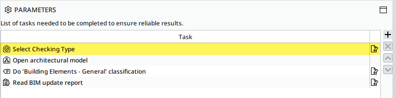

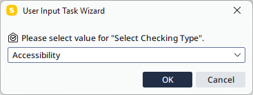

Tip
When you open a User Input task in the To-Do List, you're asked to select a value from the list:
