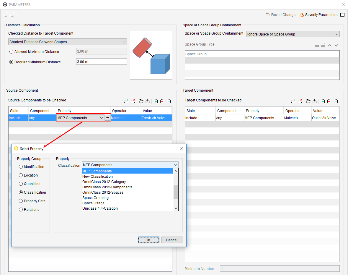

A ruleset has links to classification i.e. a ruleset refers to a classification.

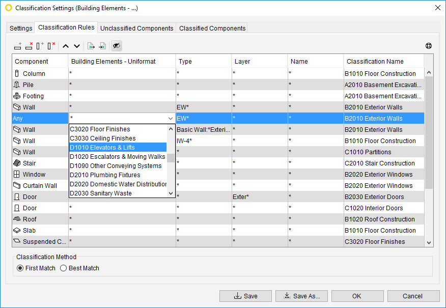

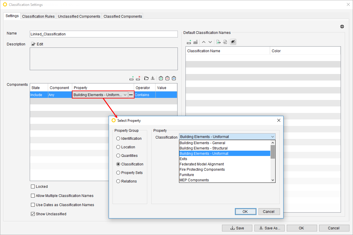

A classification is linked to another classification by using another classification in Classification rules as well as in Classification settings. See the images below:

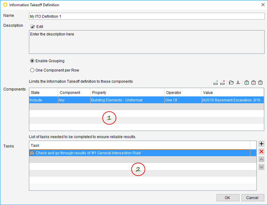

An ITO is linked to a classification using the ITO settings as well as it is linked to a ruleset using a task. See the image below:

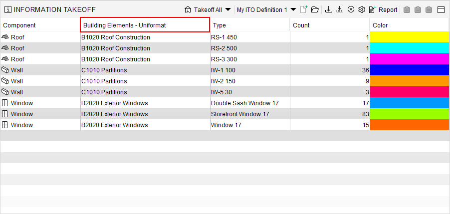

An ITO is linked to a classification when it refers to a classification either by taking components from classification or in its columns.

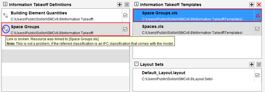

An ITO is also linked to an Information Takeoff Template and if it is missing, then that ITO definition is marked with the broken link icon ''.
