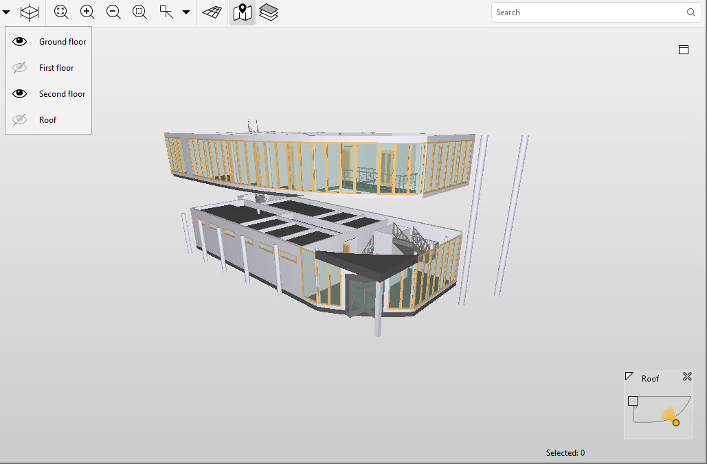

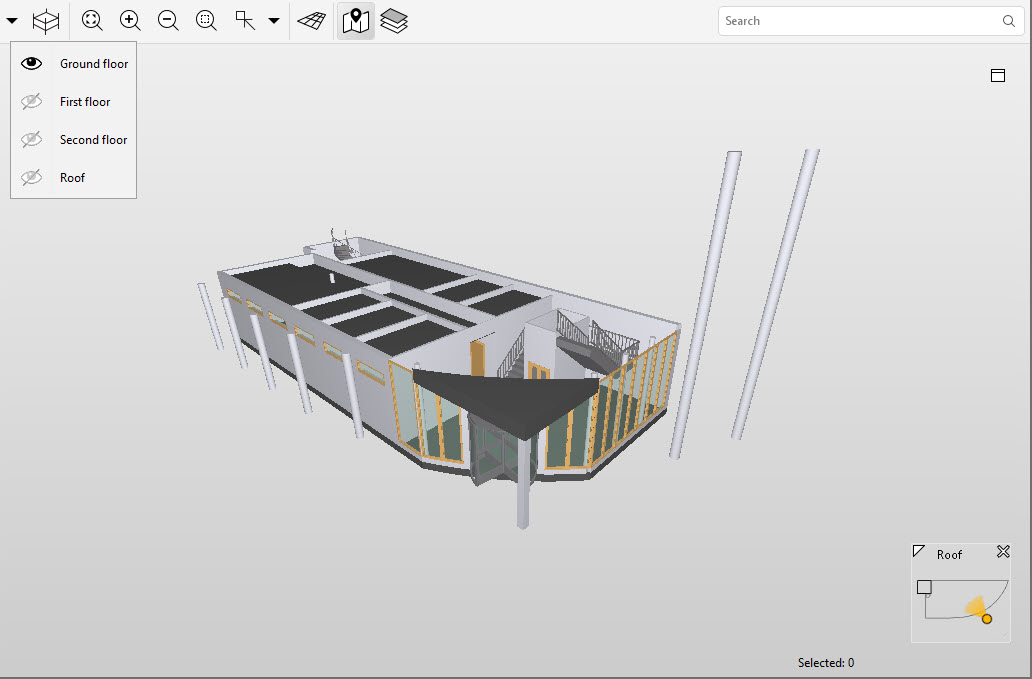

To isolate and visualise a single floor, click the floor name. The visibility of a floor is indicated with an open eye/crossed eye icon:
The corresponding floor is shown in the 3D view:
As with most applications in Windows or macOS, you can select multiple floors by Ctrl / Cmd + click or select a list by picking one floor and then Shift + click at the end of your selection:
