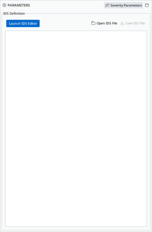

With the IDS-Rule you can:
Click Open IDS File to browse to an .ids file.
Or drag and drop an IDS file into the Checking view or Parameters view; the file is attached automatically and, if necessary, a ruleset is create
Click Save IDS File to download the IDS currently used in the rule

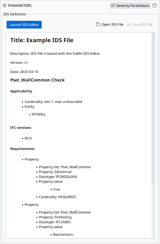

Once loaded, a preview of the IDS-structure is in the parameters so that you can review the specifications before running the check

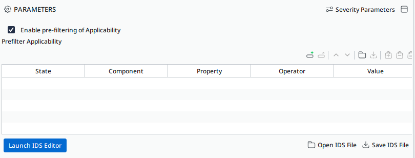

Pre‑filtering of Applicability (new)
At the top of the parameters you can enable Pre‑filter Applicability to limit which components enter the IDS check
When the option is enabled, you can define filter rows (State, Component, Property, Operator, Value) similar to other component filters in Solibri
Only components that pass this pre‑filter are passed on to the IDS applicability step; everything else is ignored by the rule
You can use this to focus the check on particular disciplines, classification codes, phases or any other combination supported by the standard Solibri filter
This improves performance in large models and lets you run different IDS checks on different subsets of the model.

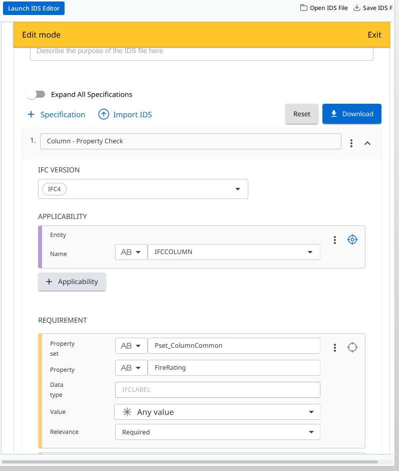

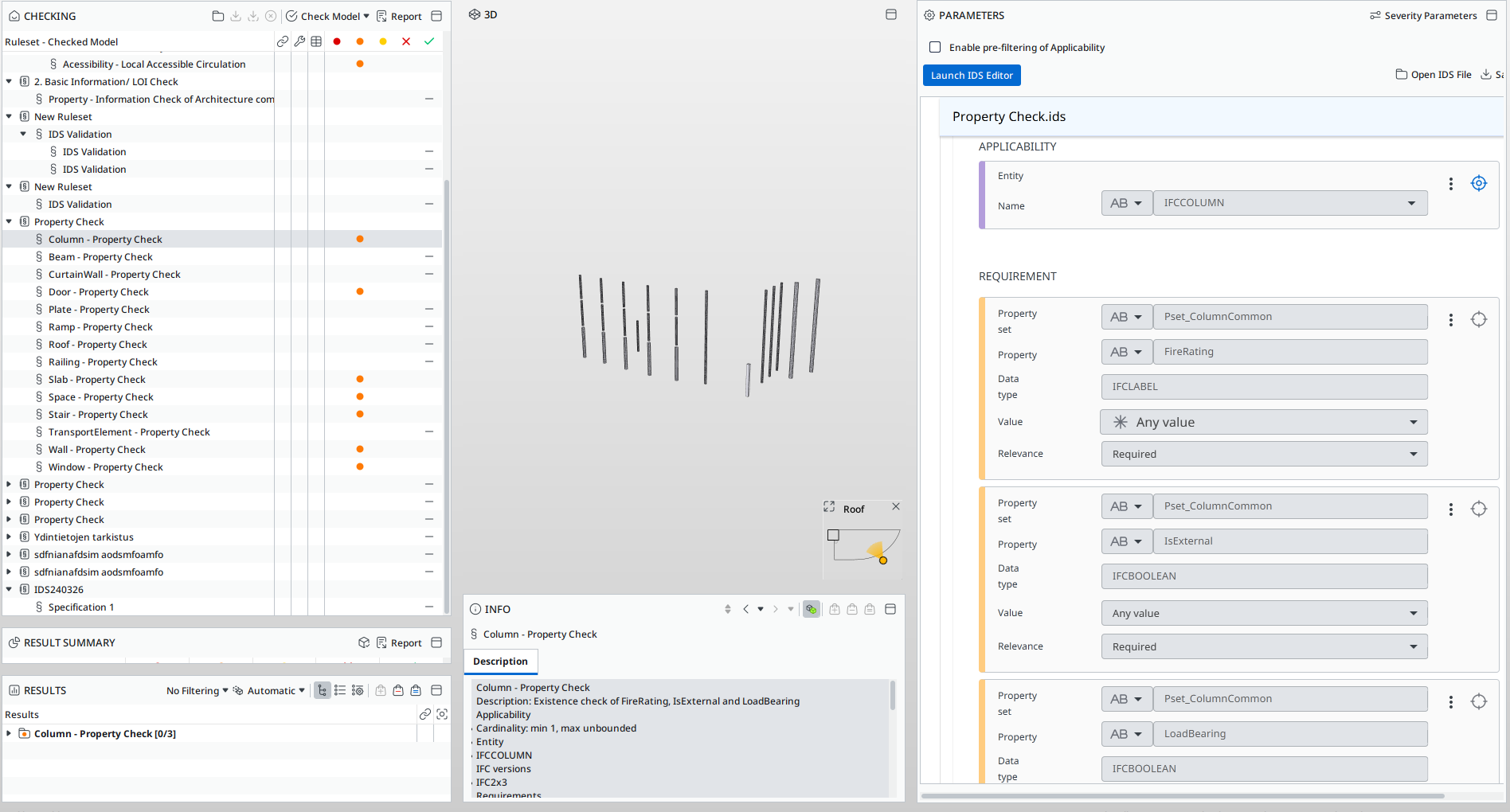

Working with IDS in the Rule (embedded IDS Editor view)
When you have selected an IDS file, the Solibri IDS Editor web view for that file is shown directly in the Parameters view. This is the same UI that you use in the standalone IDS-Editor.
The view works as follows:
Use the Edit button in the yellow bar to switch the current IDS into Edit mode.
In edit mode, you can add, modify or remove Applicability and Requirement facets using the+ Applicability and+ Requirement buttons, just like in the standalone IDS Editor.
Any changes you save in this embedded view are written back to the same IDS file that the rule uses, so you can immediately re‑run the check with the updated specification.

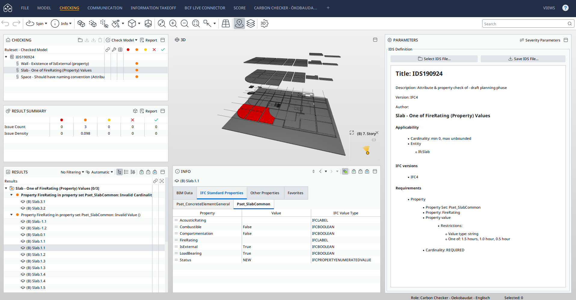

When the check is run, the rule creates issues for components that do not satisfy the IDS requirements
For each issue you can see:
Which specification the component was checked against.
Which applicability and requirement facets were applied.
Which properties, attributes or other information are missing or incorrect.
Components that meet all requirements appear as Passed in the checking results, and components outside the applicability are shown as Irrelevant

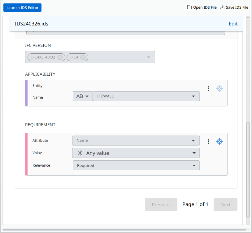

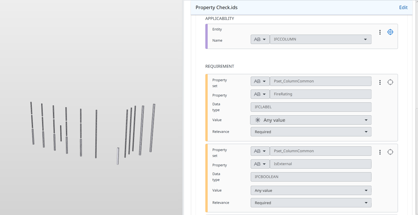

Targeting components from the Applicability or Requirement
In the embedded IDS view you can use the blue target icon to filter the model preview to the components that match a specific part of the IDS. When you click the target icon in an Applicabilityblock (for exampleEntity = IFCOLUMN), the 3D view is filtered to show only the components that satisfy that applicability. When you click the target icon in a Requiremen tblock (for example a specific property requirement), the preview is filtered further so that only components that both satisfy the applicability and fulfill this requirement remain visible. This lets you step through the specification facet by facet and visually see which components pass each stage in the 3D view.

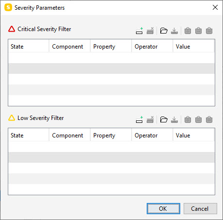

Severity Parameters:
By default, all components not matching the requirements return a medium () issue. To specify the critical and low severities for specific components, open the Severity Parameters view and set the conditions in the filter table:
