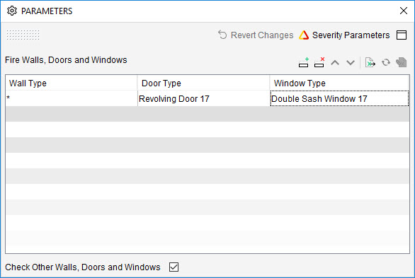

The rule parameters are:
Fire Walls, Doors, and Windows:
This table contains a list of fire protecting Construction Types for walls, doors, and windows. The types are considered independent of each other. That is, the Wall Type, Door Type, and Window Type columns do not form a relation. They are put into one table just to save space. You can also read values to this table from Excel.
Check Other Walls, Doors, and Windows:
When this is checked, the rule creates an issue if fire protecting components are used in walls that do not separate Fire Compartments.
