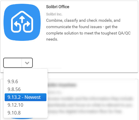

If you have a perpetual Solibri license and a company account in Solution Center:
Go to Solution Center and sign in with your credentials.
Select your operating system from the drop-down menu.
Select Solibri Office/Solibri Site from the list of products and select the latest version from the drop-down menu.
Open the file and follow the installer instructions (see more below).

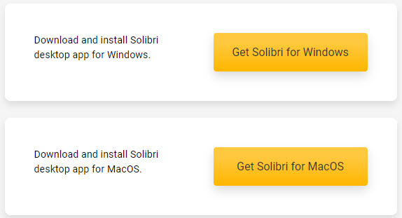

If you are a Solibri Office Subscription user:
Go to https://buy.solibri.com and sign in with your credentials.
Click Menu in the top right corner of the page and select My Downloads.
Select the correct installer for your operating system (Windows/MacOS) and download it:

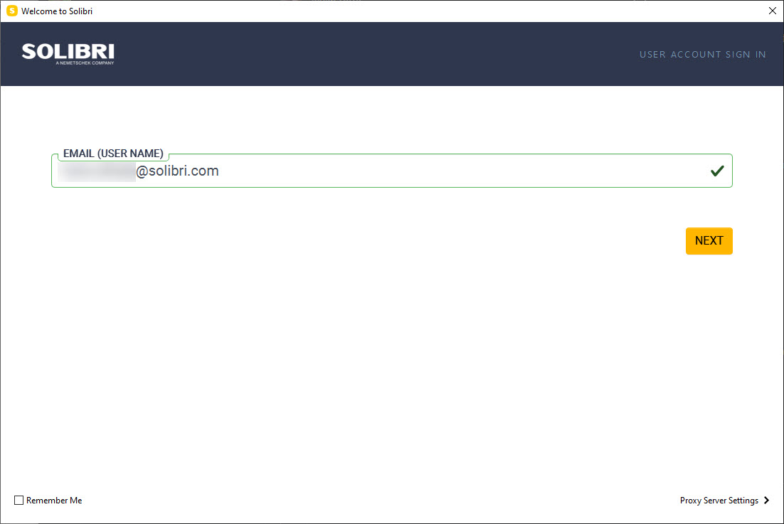

A sign-in window opens. Enter your email (user name) and click Next:

If you wish to save your credentials, mark the Remember Me checkbox.
If you are using a proxy server, you need to first determine the proxy server settings. To access the settings, click Proxy Server Settings in the bottom right corner of the sign-in window.
Mark the Remember Me checkbox when signing in. Otherwise, you will lose the proxy settings you have configured. For more detailed information on the settings, see Proxy Server Settings.

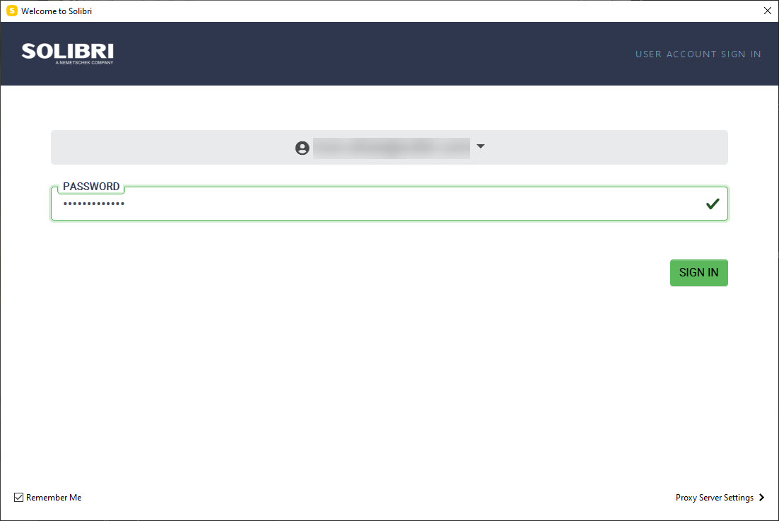

Enter your password and click Sign in:

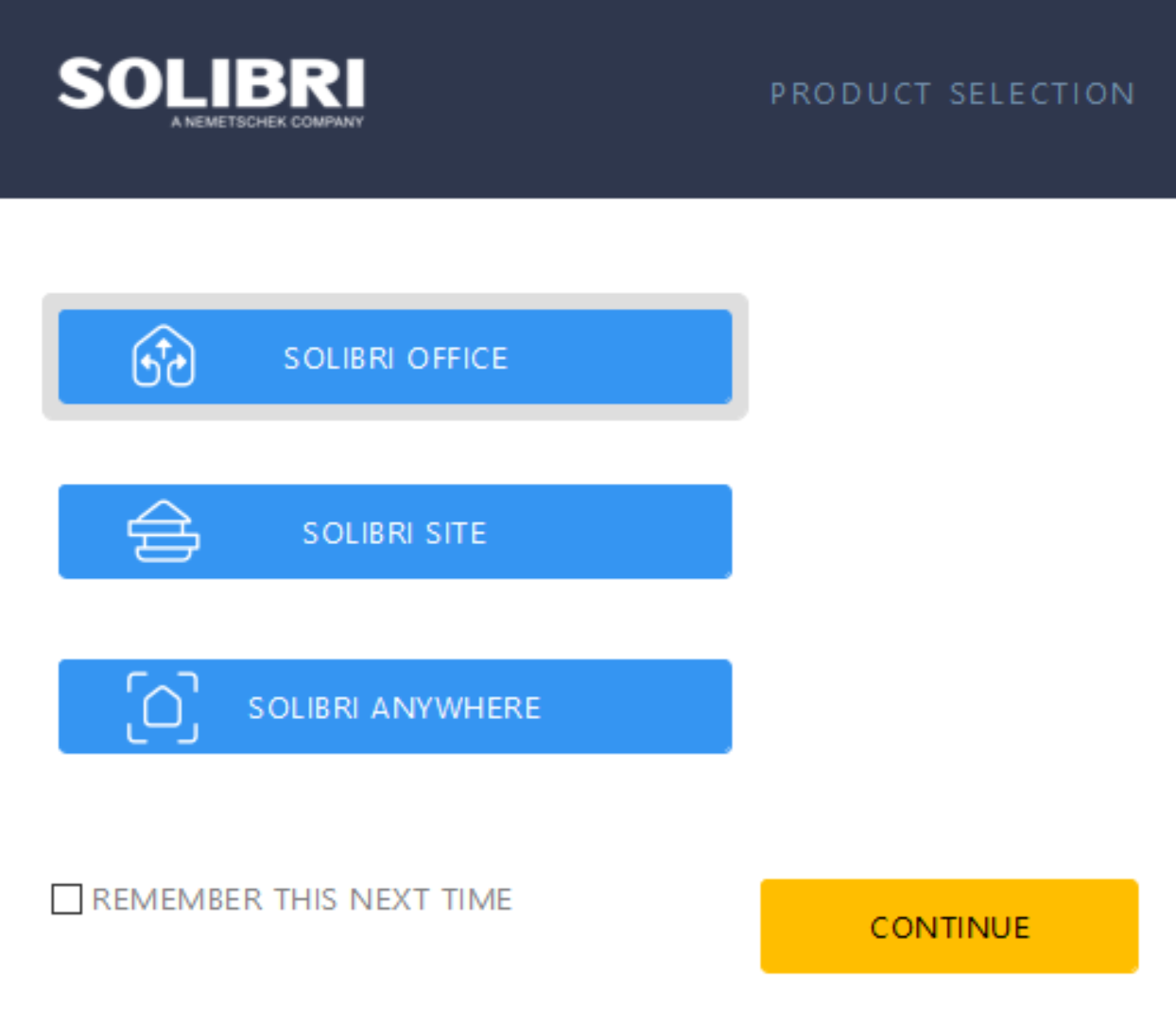

The product selection dialog opens. Select the product and click Continue.:
Tip
If you wish to save your selection, mark the Remember This Next Time checkbox. Note that if you wish to open another product, you need to unmark this selection in General Settings and restart Solibri.
The selected product is launched. When you open Solibri Site or Office for the first time, a License Agreement dialog opens. Click Accept.
