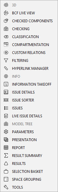

Add views to the layout by clicking Views from the top right corner of the layout bar and selecting from the list:

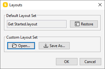

Go to File, then Settings, then Layouts.
Click Save As:

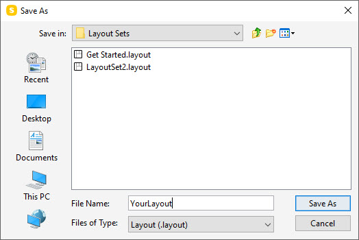

Choose the location (by default, it's the Layout Sets folder in the example files), name the layout and click Save As:
