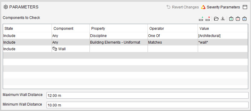

The rule parameters are:
Components to Check:
The previous parameters such as Discipline, Classification and Classification Names table are replaced by a Filter Parameter table. The Filter Parameter table allows a more precise selection of components such as walls having area equal to 3.00 m2 and yields very accurate and specific results. The previous parameters are converted to the filter parameter which includes the selected discipline and selected classification and the value from the classification Names, as shown in the above screenshot.
Maximum Wall Distance:
Maximum value for the distance between two parallel walls.
Minimum Wall Distance:
Minimum value for the distance between two parallel walls.
