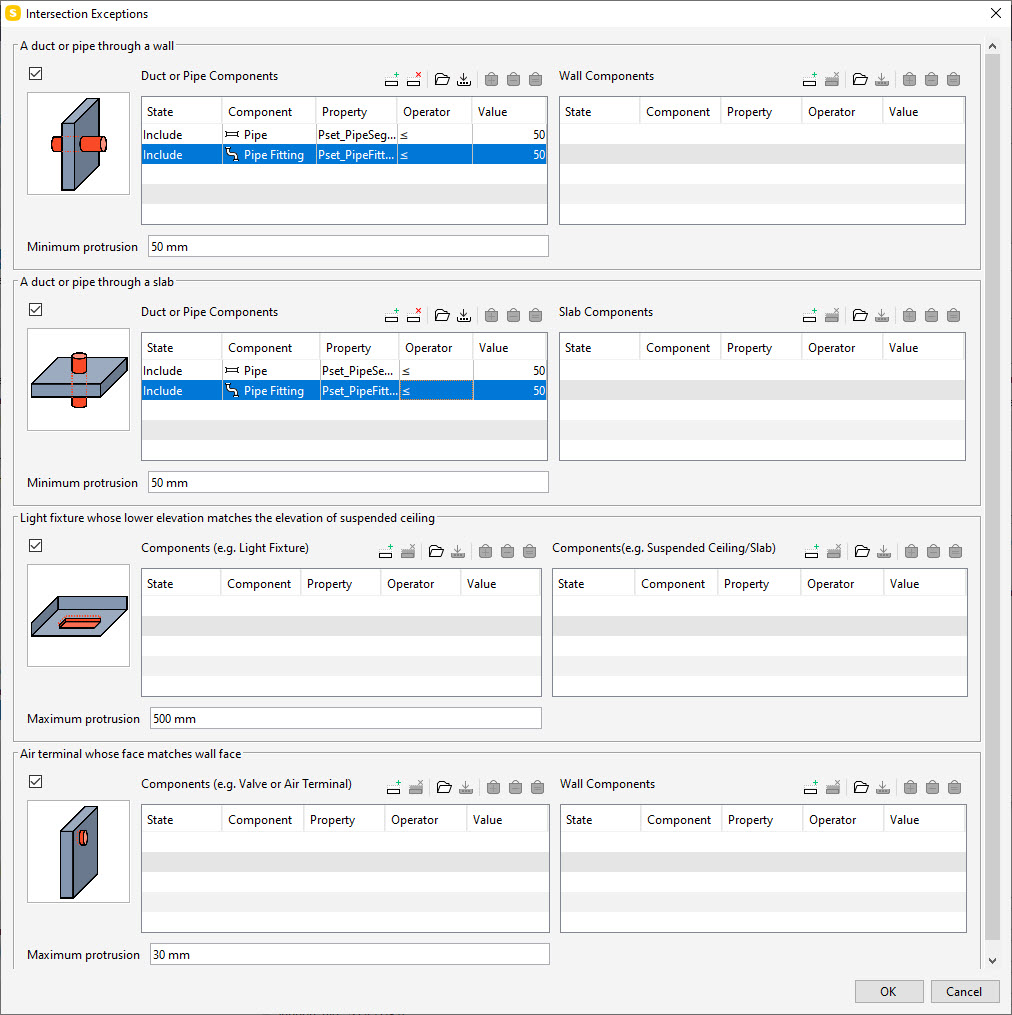

Intersection Exceptions:
In the Intersection Exceptions dialog, you can define the components and intersection types which will be ignored and therefore not included in checking:
To open the Intersection Exceptions dialog, click Exceptions.
When you are checking the intersections between ARC/STR and MEP components, it is possible to list those exceptions where the checking of intersections is considered irrelevant or not required. Typically, these are small pipes, ducts but also air terminals/valves or lighting fixtures that are wall or ceiling mounted on the component surface level.
A duct or pipe through a wall:
You have to include the components into exceptions in component filters: wall (or other wall kind of a component) vs pipe/duct (or other long component), but the duct or pipe needs to be orthogonal (89 - 90 degree angle) to the wall. This means that all these components will be ignored in this rule.
Minimum Protrusion: This parameter allows you to specify the tolerance of a protrusion for a duct or pipe through the wall on the other side. Using this value, the pipe or duct must protrude on the other side of the wall within the limits of the value so the intersections between the duct or pipe and wall are ignored and no issues are reported in the Results view. If their protrusion exceeds the tolerance value, then they are not ignored, and an issue is created in the Results view about them.
A duct or pipe through a slab:
You have to include the components into exceptions in component filters: slab (or other slab kind of a component) vs pipe/duct (or other long component), but the duct or pipe needs to be orthogonal (89 - 90 degree angle) to the slab. This means that all these components will be ignored in this rule.
Minimum Protrusion: This parameter allows you to specify the tolerance of protrusion for a duct or pipe through the slab on the other side. Using this value, the pipe or duct must protrude on the other side of the slab within the limits of the value so the intersections between the duct or pipe and slab are ignored and no issues are reported in the Results view. If their protrusion exceeds the tolerance value, then they are not ignored, and an issue is created in the Results view about them.
A light fixture through a suspended ceiling:
You need to use this option when the lower elevation of the components match. You have to include the components into exceptions in component filters: e.g. light fixture vs suspended ceiling,
Maximum Protrusion: This parameter allows you to specify the tolerance of protrusion for a light fixture below the suspended ceiling or slab. Using this value, the light fixture can protrude below the suspended ceiling or slab within the limits of the value so the intersections between the light fixture and the suspended ceiling or slab are ignored and no issues are reported in the Results view. If their protrusion exceeds the tolerance value i.e. the light fixture protrudes more than the specified value below the suspended ceiling or slab, then they are not ignored, and an issue is created in the Results view about them.
An Air Terminal which face match the wall face:
Tou need to use this option when the faces of these components match. You have to include the components into exceptions in component filters: e.g. air terminal vs wall.
Maximum Protrusion: This parameter allows you to specify the tolerance of protrusion for an air terminal or valve that matches the face of the wall. Using this value, the air terminal can protrude from the face of the wall within the limits of the value so the intersections between the air terminal and the face of the wall are ignored and no issues are reported in the Results view. If their protrusion exceeds the tolerance value i.e. the air terminal protrudes more than the specified value from the face of the wall, then they are not ignored, and an issue is created in the Results view about them.

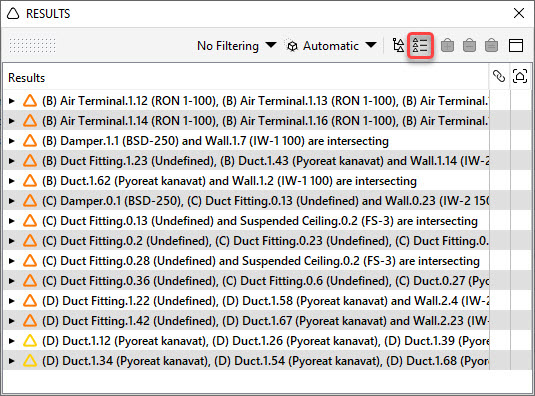

The rule results are divided into result categories, which are further divided into type, issue and component levels. You can open the sub-level by clicking the arrow on the left:
The category order in the Results view tree is:
Disciplines (only, if several disciplines are selected in parameters)
Component Types or Systems (only, if multiple component types is selected in parameters)
Intersection Types
Construction Types
When MEP systems are checked against other disciplines, the category levels are:
Component type (Wall, Slab)
Intersected component (Slab)
System of intersecting components
When you select the Type level category, you can see all the components which cut across the intersected component at once.
When you select the System level category, you can see the intersecting components of one system.

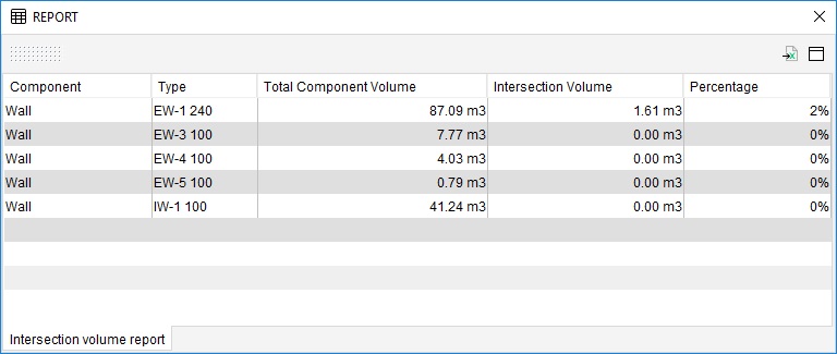

Reported Data:
The General Intersection Rule has a report about intersection volumes. Intersecting components are organized according to their construction types (spaces by space types). Total component volume and total intersection volume (actual value and percentage value compared to total component volume) are reported. The report gives you an overview about how much extra volume there is in the model of each construction type:
