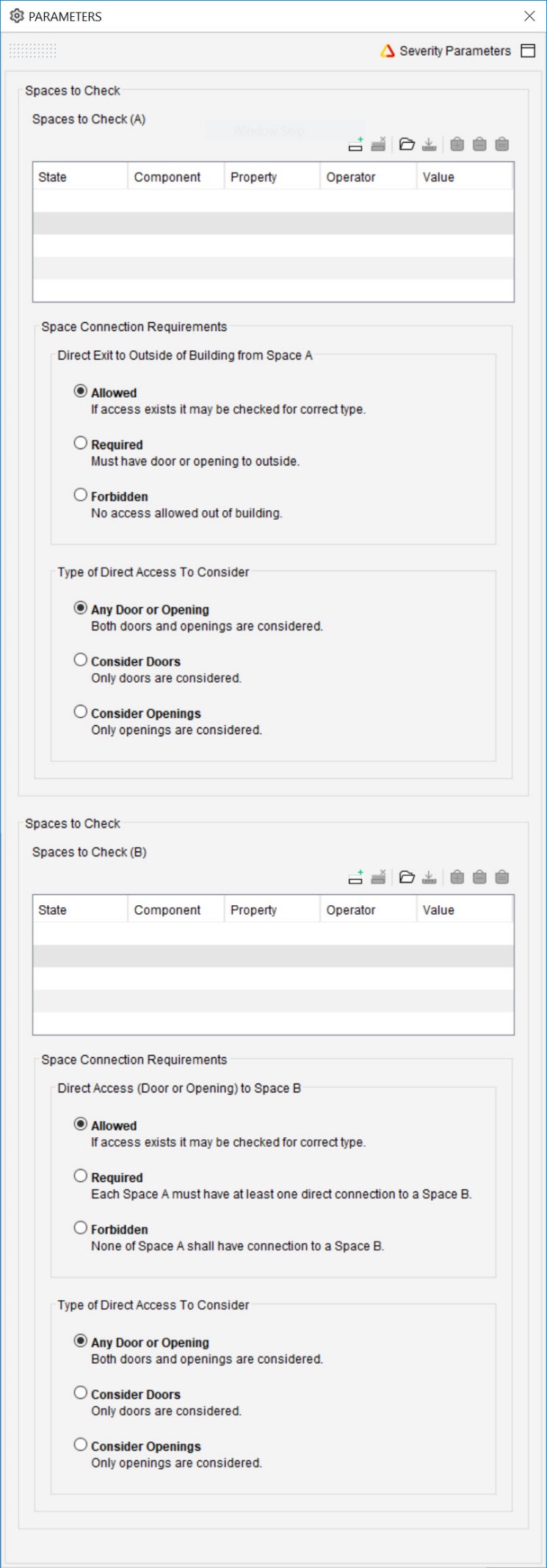

The rule parameters are:
Spaces to Check (A):
This filter is used to define the spaces that are considered spaces of type A. Spaces of type A are checked for direct access to outside of building and direct access to spaces of type B.
Space Connection Requirements:
These space connection requirements are for specifying if direct access from a Space A to Outside is allowed, required or forbidden and what type of connection between a Space A and Outside is considered direct access.
Direct Exit to Outside of Building from Space A: This option is used to select if direct access from a Space A to Outside is allowed, required or forbidden. What Direct Access means is defined by "Type of Direct Access to Consider". The type of connection selected by "Type of Direct Access to Consider" is considered Direct Access between a Space A and Outside.
Allowed: When this option is selected and
"Any Door or Opening (A to Outside)" is selected, direct access by any door or opening is allowed but not required between a Space A and Outside. No issue is created here.
"Consider Doors (A to Outside)" is selected, connection between a Space A and Outside by only opening is not allowed, but a connection between Space A and Outside is not required. For example,
a Space A connected to Outside by a door and an opening is allowed.
a Space A not connect to Outside by anything is allowed because type of connection is checked if there is connection, but connection is not required.
a Space A connected to Outside by only openings is not allowed.
An issue is created for a Space A if it is connected to Outside by only openings.
"Consider Openings (A to Outside)" is selected, connection between a Space A and Outside by only door is not allowed, but a connection between Space A and Outside is not required. For example,
a Space A not connected to Outside by anything is allowed because type of connection is checked if there is connection, but connection is not required.
a Space A connected to Outside by only doors is not allowed.
An issue is created for a Space A if it is connected to Outside by only doors. No issue is created for a Space A if it is not connected to Outside by anything.
Required: When this option is selected and
"Any Door or Opening (A to Outside)" is selected, direct access by any door or opening is required between a Space A and Outside. An issue is created for a Space A if it is not connected to Outside by any door or opening.
"Consider Doors (A to Outside)" is selected, direct access by at least one door is required between a Space A and Outside. An issue is created for a Space A it is not connected to Outside by any door.
"Consider Openings (A to Outside)" is selected, direct access by at least one opening is required between a Space A and Outside. An issue is created for a Space A it is not connected to Outside by any opening.
Forbidden: When this option is selected and
"Any Door or Opening (A to Outside)" is selected, direct access by any door or opening from a Space A to Outside is forbidden. This means an issue is created for a Space A if it is connected to Outside by any door or opening.
"Consider Doors (A to Outside)" is selected, direct access by any door from a Space A to Outside is forbidden. This means an issue is created for a Space A if it is connected to Outside by any door.
"Consider Openings (A to Outside)" is selected, direct access by any opening from a Space A to Outside is forbidden. This means an issue is created for a Space A if it is connected to Outside by any opening.
Type of Direct Access to Consider (A to Outside): This option is used to select the requirement for the type of connection from a Space A to Outside.
Any Door or Opening (A to Outside): When this option is selected, any door or opening between a Space A and Outside is considered Direct Access between them. This option also creates additional requirements in combination with "Allowed" under "Direct Exit to Outside of Building from Space A".
Consider Doors (A to Outside): When this option is selected, any door between a Space A and Outside is considered Direct Access between them. This option also creates additional requirements in combination with "Allowed" under "Direct Exit to Outside of Building from Space A".
Consider Openings (A to Outside): When this option is selected, any opening between a Space A and Outside is considered Direct Access between them. This option also creates additional requirements in combination with "Allowed" under "Direct Exit to Outside of Building from Space A".
Spaces to Check (B):
This filter is used to define the spaces that are considered spaces of type B.
These space connection requirements are for specifying if direct access from a Space A to a Space B is allowed, required or forbidden and what type of connection between a Space A and a Space B is considered direct access.
Direct Access (Door or Opening) to Space B: This option is used to select if direct access from a Space A to a Space B is allowed, required or forbidden. What Direct Access means is defined by "Type of Direct Access to Consider". The type of connection selected by "Type of Direct Access to Consider" is considered Direct Access between a Space A and a Space B.
"Any Door or Opening (A to B)" is selected, direct access by any door or opening is allowed but not required between a Space A and a Space B. No issue is created here.
"Consider Doors (A to B)" is selected, connection between a Space A and a Space B by only opening is not allowed, but a connection between Space A and Space B is not required. For example,
a Space A connected to a Space B by a door and an opening is allowed.
a Space A not connected to a Space B by anything is allowed because type of connection is checked if there is connection, but connection is not required.
a Space A connected to a Space B by only openings is not allowed.
An issue is created for a Space A if it is connected to a Space B by only openings.
"Consider Openings (A to B)" is selected, connection between a Space A and a Space B by only door is not allowed, but a connection between Space A and Space B is not required. For example,
a Space A not connect to a Space B by anything is allowed because type of connection is checked if there is connection, but connection is not required.
a Space A connected to a Space B by only doors is not allowed.
An issue is created for a Space A if it is connected to a Space B by only doors. No issue is created for a Space A if it is not connected to a Space B by anything.
"Any Door or Opening (A to B)" is selected, direct access by any door or opening is required between a Space A and a Space B. This means an issue is created for a Space A if it is not connected to a Space B by any door or opening.
"Consider Doors (A to B)" is selected, direct access by at least one door is required between a Space A and a Space B. This means an issue is created for a Space A if it is not connected to a Space B by any door.
"Consider Openings (A to B)" is selected, direct access by at least one opening is required between a Space A and Outside. This means an issue is created for a Space A if it is not connected to a Space B by any opening.
"Any Door or Opening (A to B)" is selected, direct access by any door or opening from a Space A to a Space B is forbidden. This means an issue is created for a Space A if it is connected to a Space B by any door or opening.
"Consider Doors (A to B)" is selected, direct access by door from a Space A to a Space B is forbidden. This means an issue is created for a Space A if it is connected to a Space B by any door.
"Consider Openings (A to B)" is selected, direct access by opening from a Space A to a Space B is forbidden. This means an issue is created for a Space A if it is connected to a Space B by any opening.
Type of Direct Access to Consider (A to B): This option is used to select the requirement for the type of connection from spaces of type A to spaces of type B.
Any Door or Opening (A to B): When this option is selected, any door or opening between a Space A and a Space B is considered Direct Access between them. This option also creates additional requirements in combination with "Allowed" under "Direct Access (Door or Opening) to Space B".
Consider Doors (A to B): When this option is selected, any door between a Space A and a Space B is considered Direct Access between them. This option also creates additional requirements in combination with "Allowed" under "Direct Access (Door or Opening) to Space B".
Consider Openings (A to B): When this option is selected, any opening between a Space A and a Space B is considered Direct Access between them. This option also creates additional requirements in combination with "Allowed" under "Direct Access (Door or Opening) to Space B".
