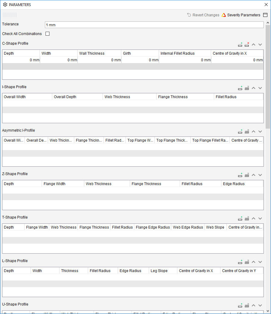

This rule checks that only listed beam and column profiles are used.
The rule parameters are:
Tolerance:
The tolerance is used in comparing parameter values of profiles with table values.
Parametric Profile Tables:
The rule has table parameters for each profile type. The tables should have listed all profiles with parameter values that are allowed in the project. Empty cells or cells with zero value mean that the parameter value is ignored in the checking, e.g., if only circular columns with radius of 200 mm and 300 mm are allowed in the project, the Circle profile table should be filled with values: 200 mm and 300 mm.
Analysing the results:
The rule creates an issue of all the columns and beam profiles that haven’t had a parametric profile, or the profile is not listed in the tables.
