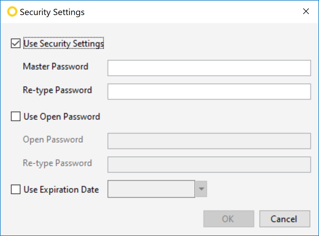

To activate the security settings, activate the Use Security Settings checkbox:

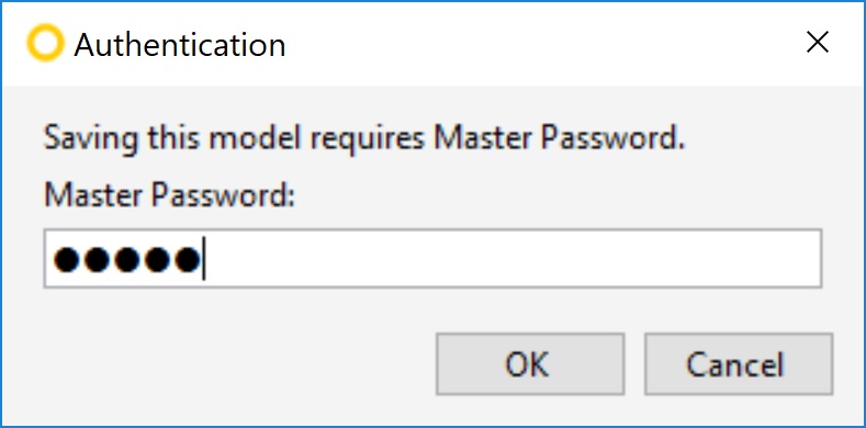

Master Password: If you want to apply security settings to the model, it's obligatory to set a Master Password. The Master Password is asked when a user wishes to save changes to a model:

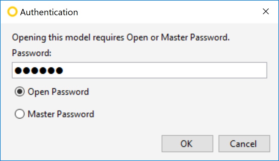

Open password: The opening or master password is asked when a user opens the model:
Saving changes to a model requires the master password.
Expiration Date: Use the drop-down dialog to select a date from the calendar.
If you set an Expiration Date, the model can only be opened after the set date with the Master Password.
Click OK to save the changes.
