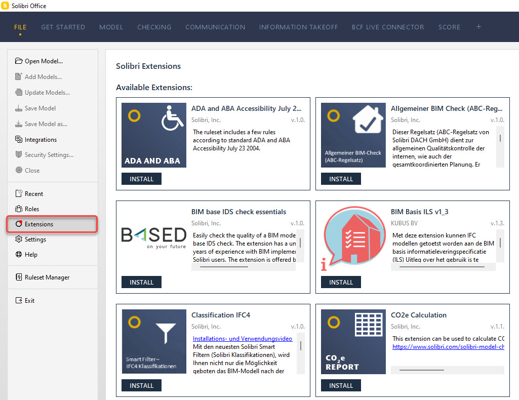

To install an Extension:
Launch Solibri Advanced or Premium.
Go to File > Extensions to see all the available Extensions
Click Install and wait for the process to complete. You can then continue to use Solibri.

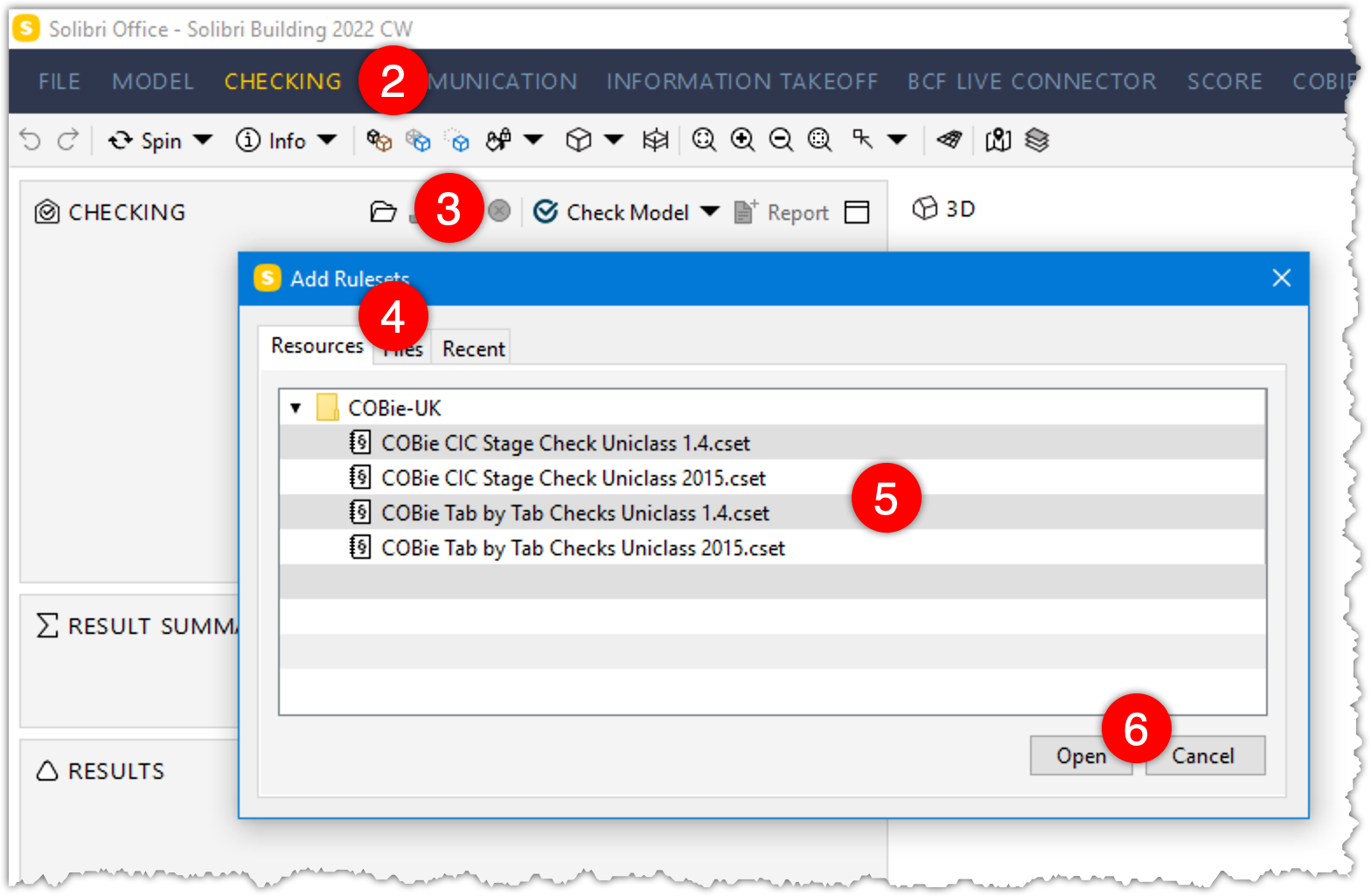

Example: Loading a Ruleset from an Extension
In this example, we will use the COBie UK Resources that work in conjunction with the COBie Platform.
Launch Solibri Advanced or Premium and open your model(s)
Go to the Checking Layout
In the Checking View ,click the Add Rulesets button
Click the Resources tab that has been added by the Extension
Select the Ruleset(s) you wish to add to the Project
Click Open
Continue to use Solibri.
