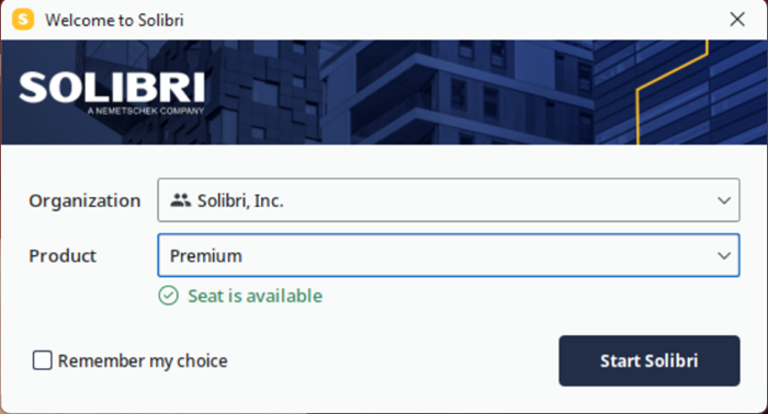

Choose an organization and product at sign-in
Sign in to Solibri Desktop.
In the Welcome to Solibri dialog, review the Organization list.
If more than one eligible organization is available, select the organization you want to use. If only one organization is available, Solibri selects it automatically.
In Product, select an available tier, such as Starter, Essential, Advanced, or Premium. Only products included in your assignment and the organization’s available licenses are shown.
Confirm the seat status. When a seat is ready, Solibri shows Seat is available.
Optionally select Remember my choice if you want Solibri to reuse this selection next time.
Select Start Solibri.

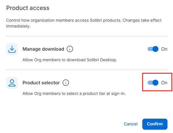

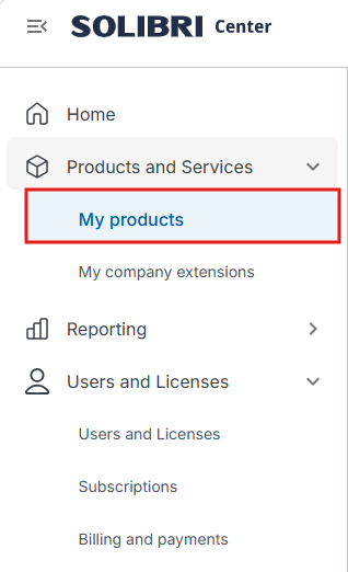

Organization administrators enable Product Selector in Solibri Center.
Open Solibri Center and sign in.
Go to Products and Services → My products.
Select Manage access.
In Product access, turn Product selector on. The description reads: Allow Org members to select a product tier at sign-in.
Select Confirm.
Product Selector enabled |
