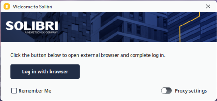

Launch Solibri Desktop.

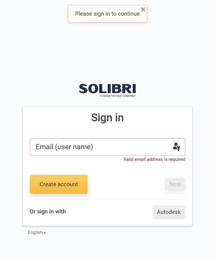

In the Welcome to Solibri dialog, click Log in with browser.
Your default web browser opens automatically. Enter your Solibri email address and password, then complete sign-in in the browser.

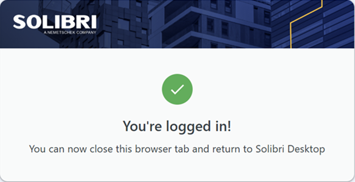

When you see the confirmation message, close the browser tab and return to Solibri Desktop.
Solibri continues loading in the application.

Optional settings on the welcome dialog
Remember me - Keeps you signed in on this computer so credentials are not requested every time you launch the application.
Proxy settings - Opens proxy configuration if your network requires it. For details, see Proxy Server Settings in the help center.

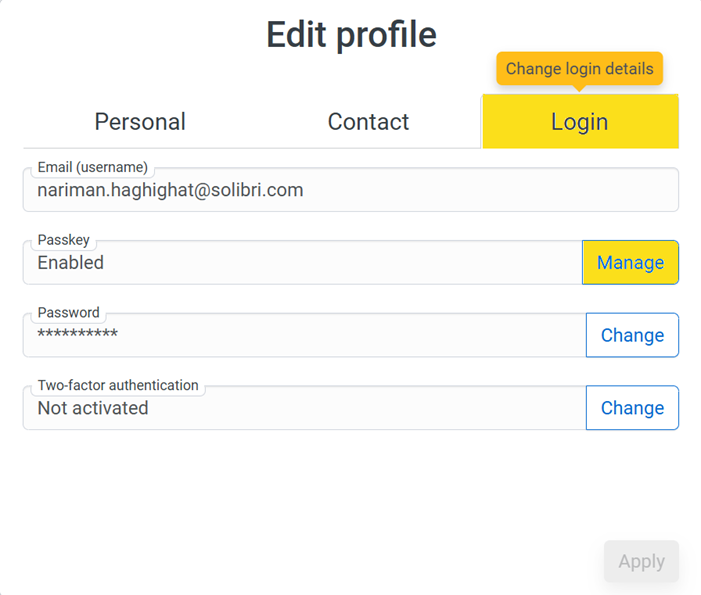

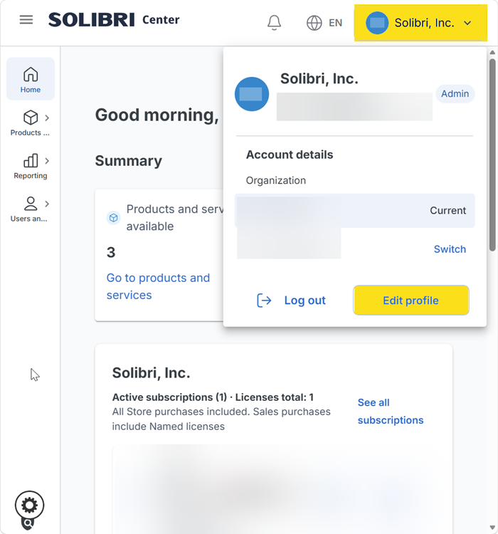

Open Solibri Center and sign in
Click your organization name in the top-right corner
Select Edit profile

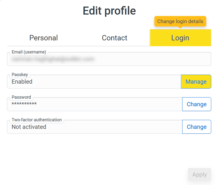

Open the Login tab

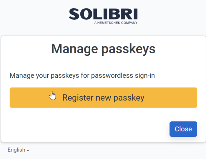

Next to Passkey, click Manage.
Click Register new passkey.
Follow the on-screen prompts on your device to complete registration.
You can now use your passkey the next time you sign in to Solibri Center or Solibri Desktop.

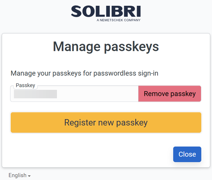

Disable Passkey Login
Click your organization name in the top-right corner → Edit profile → Logintab
Click Remove passkey
Confirm the removal when prompted
After you remove the passkey, sign in with your password instead.
If your Autodesk account uses the same email address as your Solibri license, you can sign in with Autodesk instead of a Solibri password.
Steps:
On the browser sign-in page, under Or sign in with, click Autodesk.
Enter your Autodesk credentials.
Complete sign-in. You are returned to Solibri automatically.

How to enable 2FA
Click your organization name in the top-right corner and select Edit profile
Open the Login tab
Next to Two-factor authentication, click Change
On the Configure two-factor authentication page, scan the QR code with your authenticator app, or enter the manual configuration key shown below the QR code
Enter two consecutive authentication codes from the app in Authentication code 1 and Authentication code 2
Click Activate
After activation, enter a code from your authenticator app each time you sign in to Solibri Center or Solibri Desktop.
