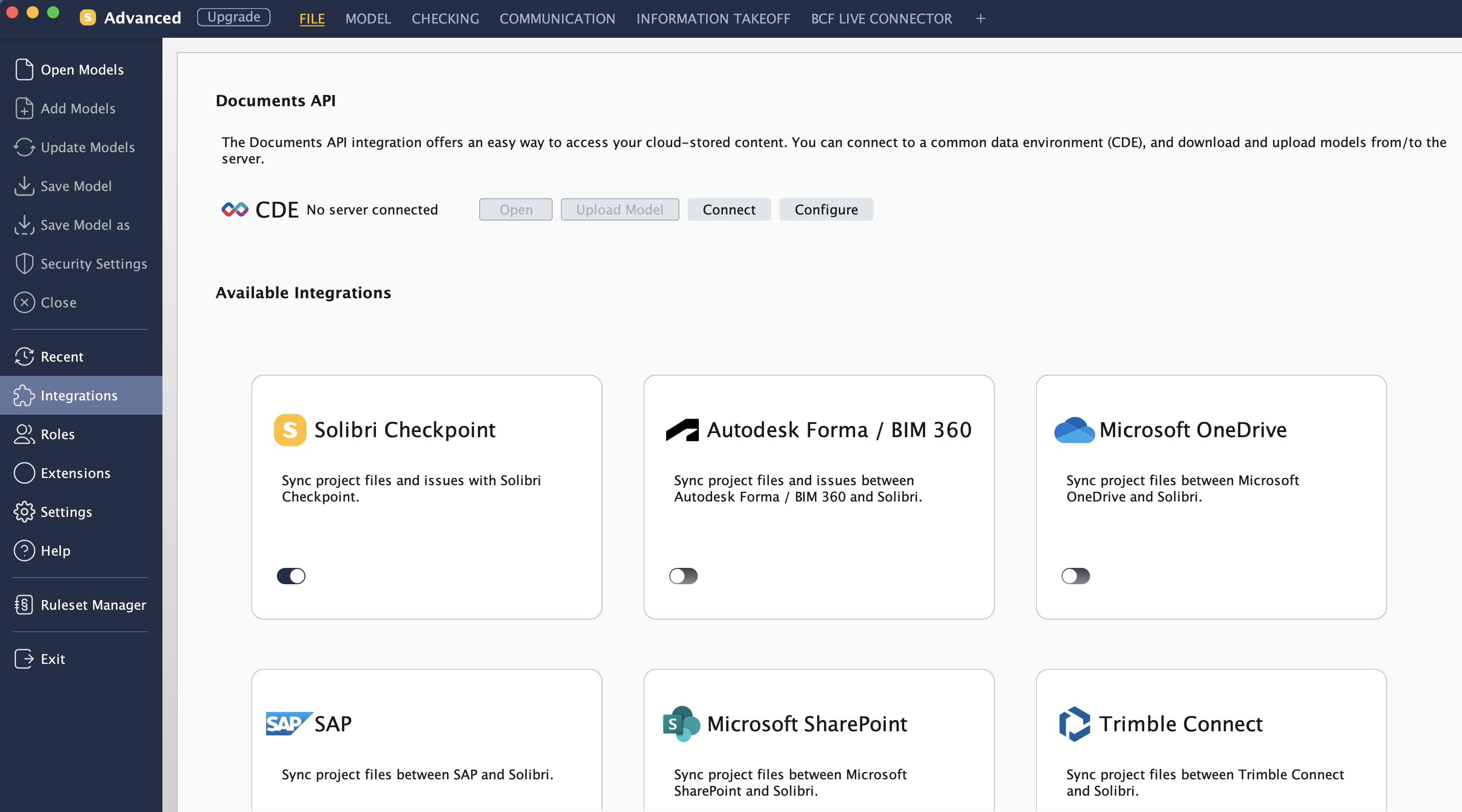

You can create and access projects either in the Solibri Cloud Platform (CheckPoint) or in Solibri Desktop, depending on your preferred workflow. To connect to CheckPoint, simply initiate the Integration under the Integrations view in Solibri Desktop.

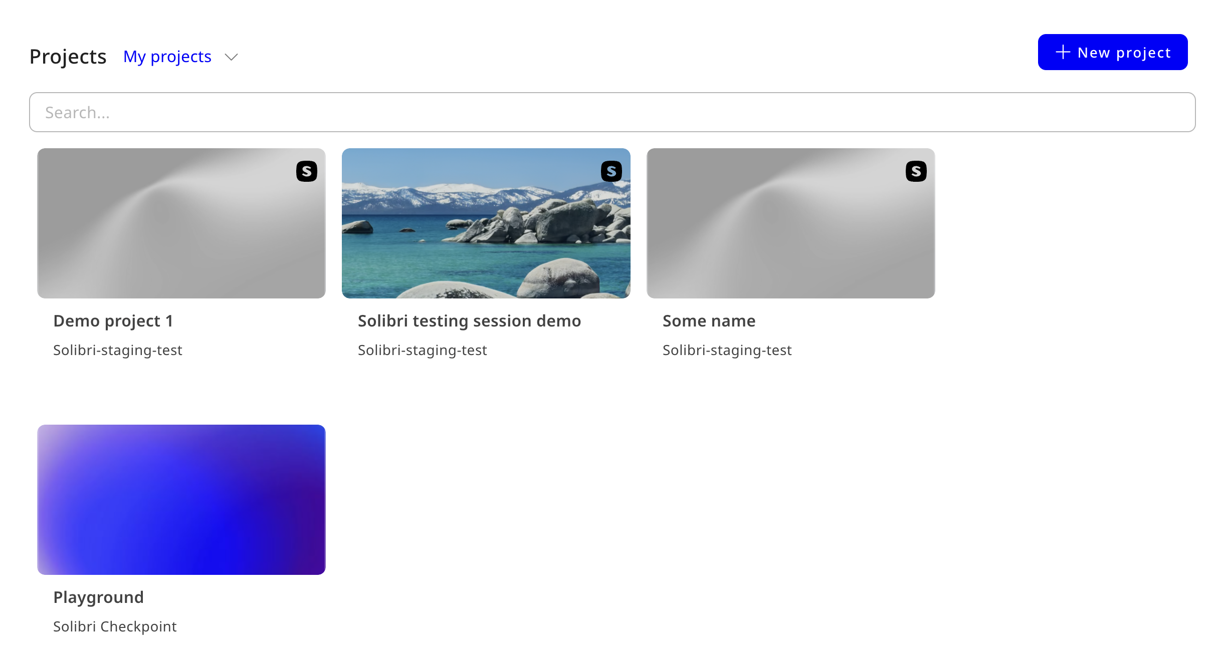

To create a new project in the Solibri Cloud Platform (CheckPoint):
Access your Solibri Cloud instance through https://checkpoint.solibri.com/
Once authenticated, you’ll land on the Projects page.
To add a new project, click the + New Project button in the top right corner.
Enter a project name and, optionally, add a cover image.
Select and upload the desired IFC files.

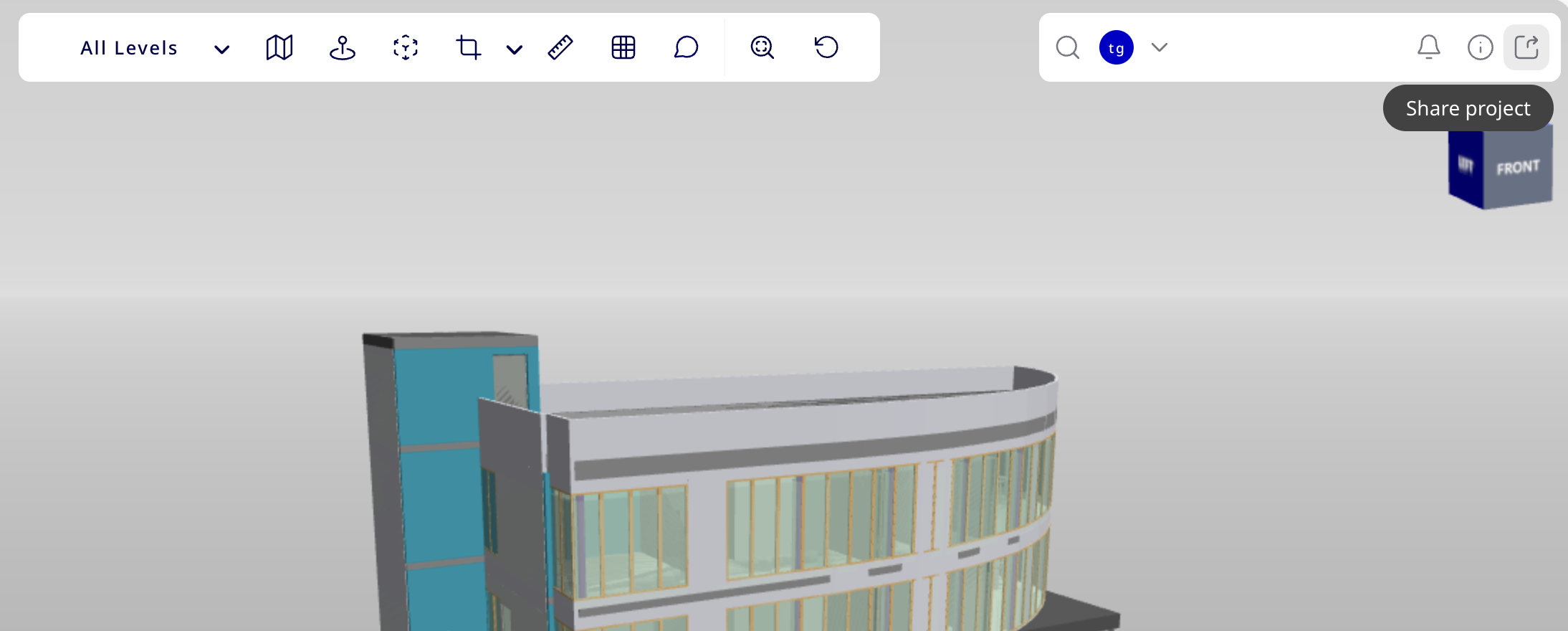

Click the Share project icon in the top right corner to invite team members and add assign them project-level roles and permissions.
Once the project is created, team members can connect to it in Solibri Desktop using the Files integration, available under Integrations.
