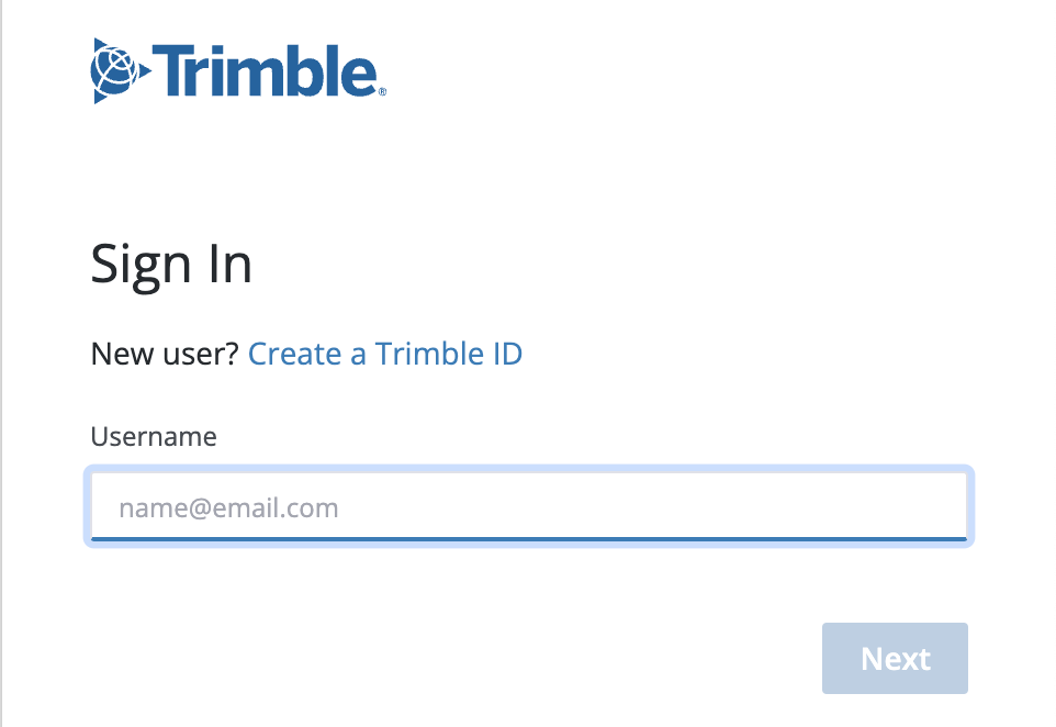

A browser page opens, and you need to authenticate the access by signing in with your Timble Connect credentials:
When the authentication is successful, you can close the browser.

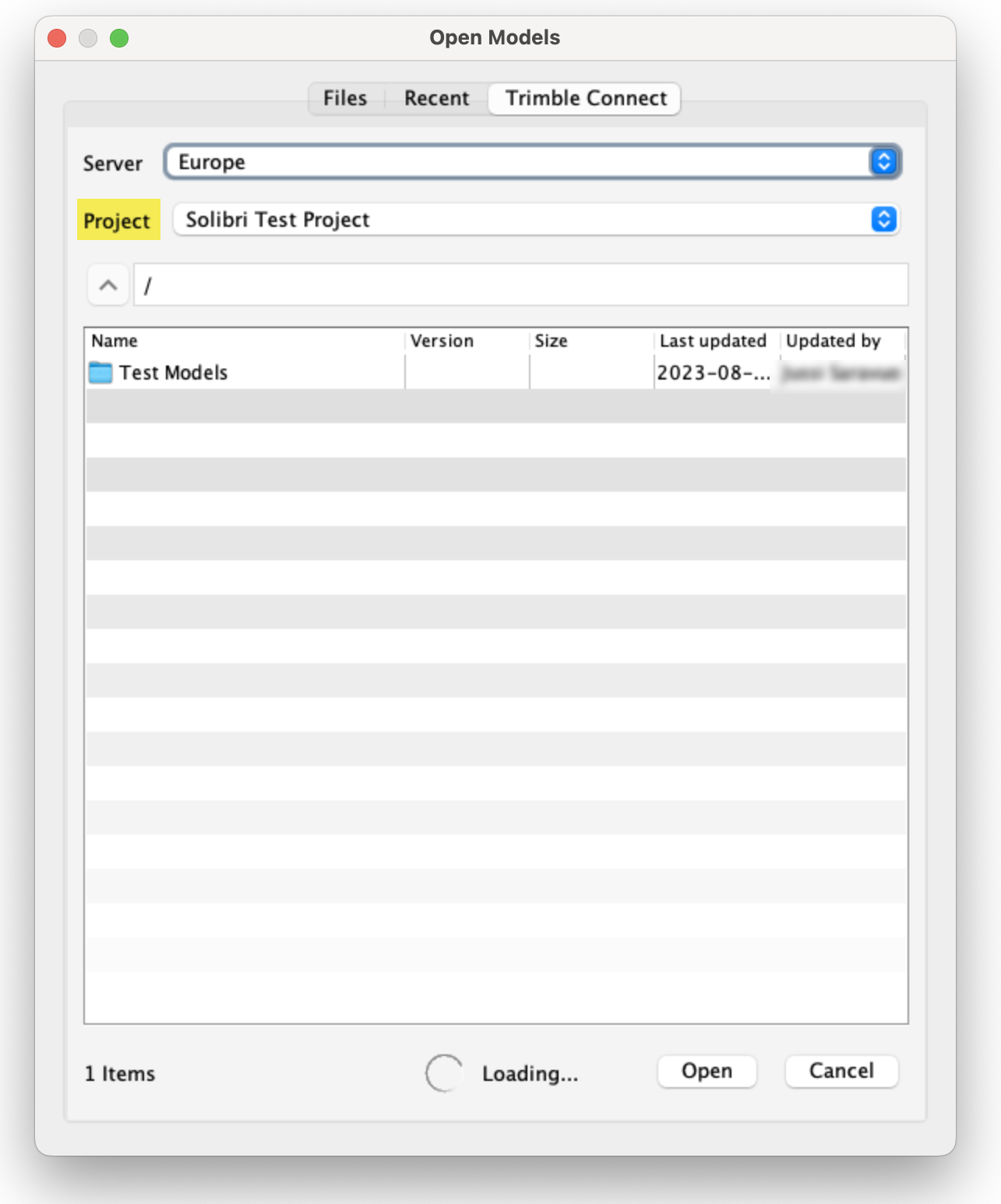

Click File > Open Models. A dialog opens. Select the Trimble Connect tab.
Select the server from the Server drop-down menu:
Select your project from the Project drop-down menu:
After selecting the project, navigate to the desired file or folder below.
In the file chooser, you can see the different files and sort them by Name, Version, Size, Last updated and Updated by by clicking the column heading:
Double click the file (or select the file(s) and click Open).

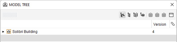

When you open an IFC, PDF or DWG file from Trimble Connect, you can see the file version number in the Model Tree view:

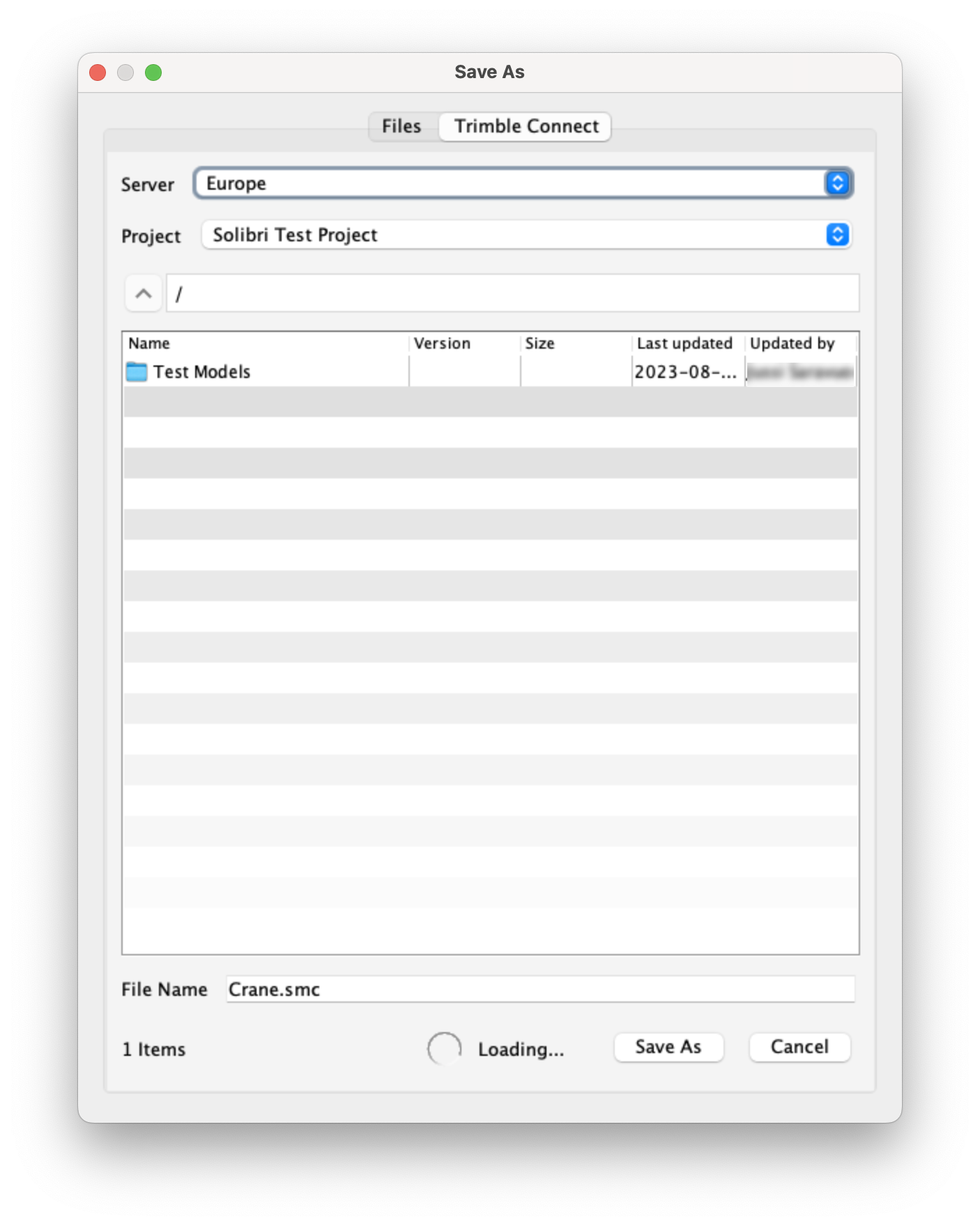

Note that you can only save SMC files into Trimble Connect. To save models into Trimble Connect:
Click Save (if saving for the first time) or Save As. A dialog opens. Go to the Trimble Connect tab.
If you have opened the file from Trimble Connect, the file chooser remembers the project. If not, first select the server and project and then navigate to the correct file location:
Select the file location and click Save or Save As.

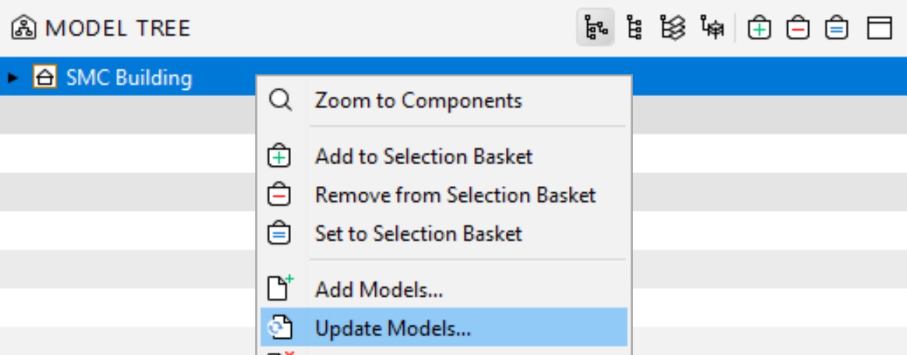

Select a model/models in the Model Tree view. Right click and select Update Models from the context menu:

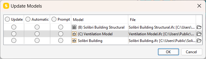

Alternatively, click File, then Update Models. The dialog below will then list all the opened models and you can select which ones you wish to update.

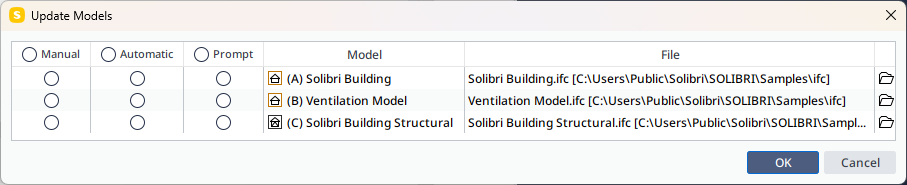

The Update Models dialog opens:
Select one of the three updating options:
Update: Requires you to manually carry out this task when you want to update any models. If the filename has changed (revision letter, date etc.) then the new version of the file will need to be located using the Folder icon (
) at the end of the row. This will need to be done for each model.
Automatic: Updates are done automatically in the background when the software is started, and during a session if the time stamp is changed. Make sure that the new version of your file(s) is located in the same folder where the original model file is, and that it has the same name. The software will update your model automatically.
Prompt: You will get a prompt when the update is available, and the updating starts at your convenience. Make sure that the new version of your file(s) is located in the same folder where the original model file is, and that it has the same name.

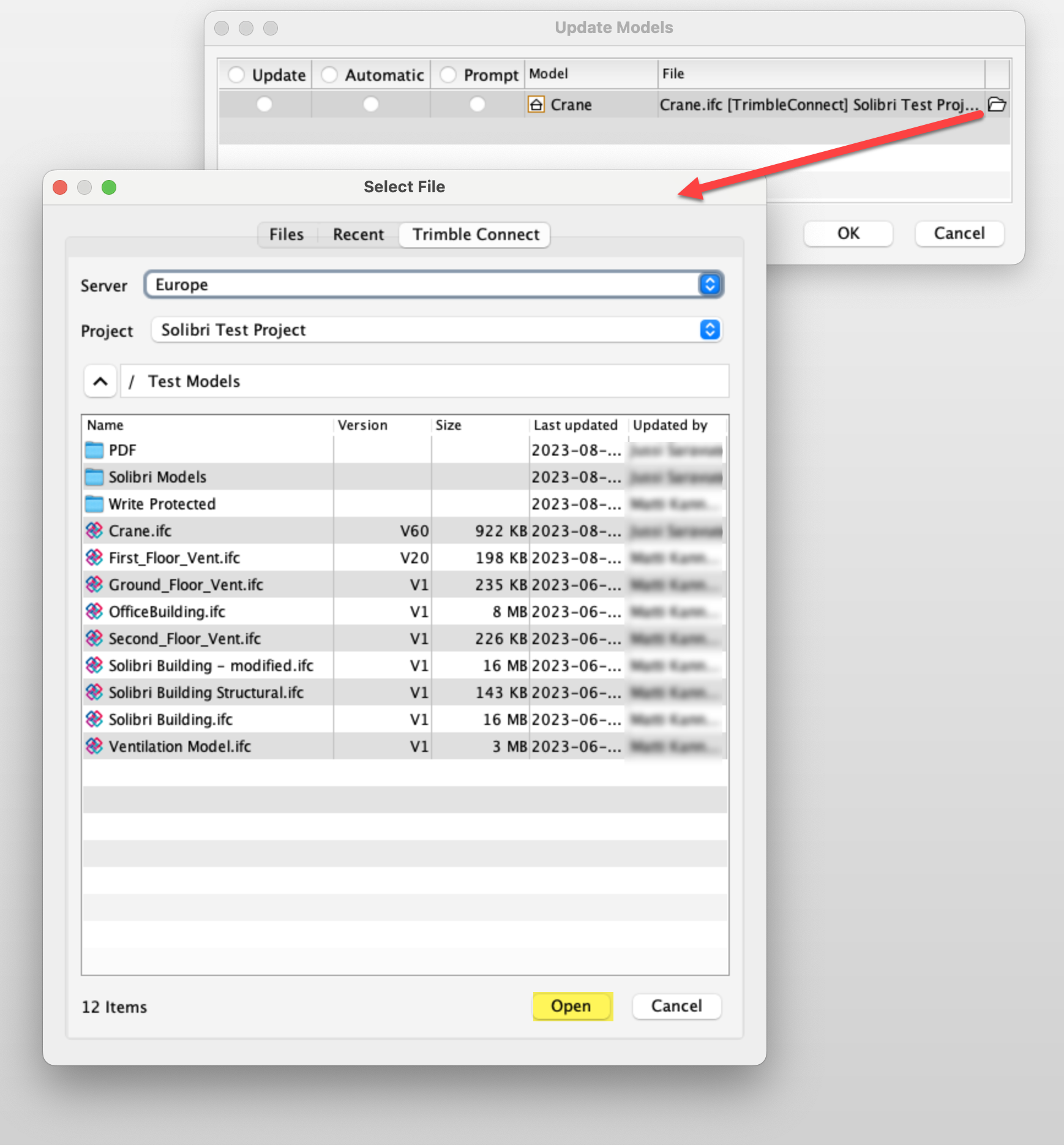

When you click
, the File Chooser dialog opens. On the Trimble Connect tab, go to the correct file location, select the file and click Open:
Click OK.
