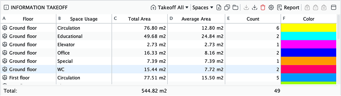

Information takeoff columns are labelled with letters (A, B, C, etc.) to help identify columns when writing formulas.

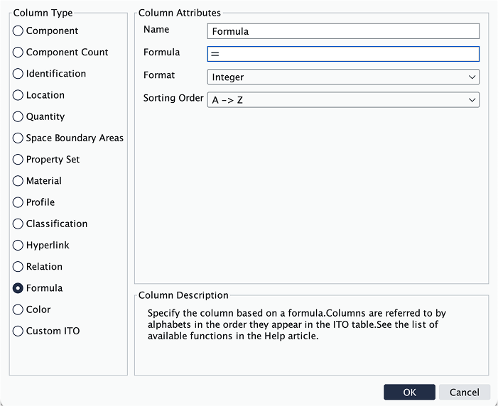

A new column type, "Formula," has been added. You can manage the columns in the ITO table as usual, either by editing an existing column or adding a new one. In the column settings, you can select the "Formula" column type.
The formula field always starts with an equals sign (=), which cannot be removed or edited.

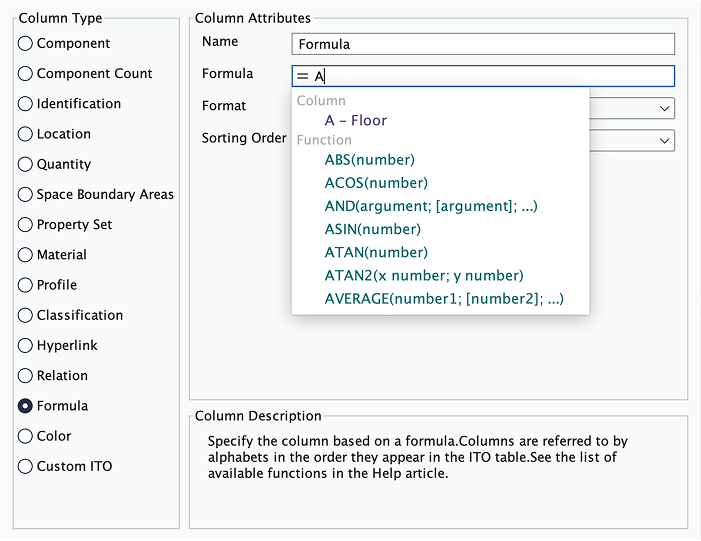

As you type, auto-suggestions appear, filtering available column names and suggesting supported functions.
When selecting a function, it is inserted with parentheses, and the cursor is placed inside the first parenthesis for easy input.
