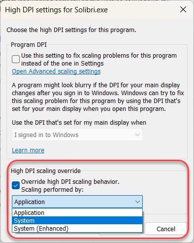

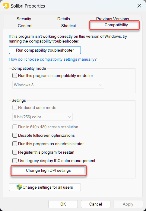

If the Solibri icons are not the correct size but look too small, there's a resolution compatibility issue between Solibri and your system. To fix this, you'll need to change the high DPI scaling settings for Solibri. To do this:
