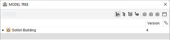

When you open a file from BIM 360, you can see the file version number in the Model Tree view:
