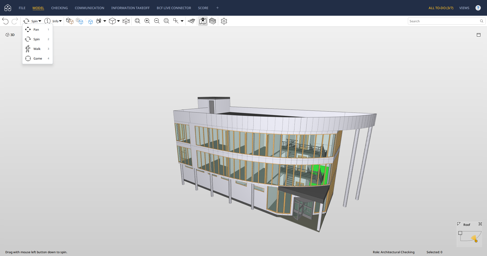

In Solibri, you have four alternative modes for navigating the model in the 3D view. In Pan and Spin modes, you can move the building on the screen and zoom into it. In Walk and Game modes, you can walk inside the building. This article explains how to use the different modes. You can select the navigation modes from the main toolbar or use keyboard shortcuts:

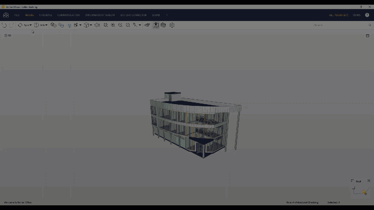

In the Pan mode, you can move the building on the screen or zoom into the building. To move the building, hold the left mouse button down and move the mouse. The keyboard shortcut for Pan mode is 1.
Tip
If you have a wheel mouse, you can leave the navigation mode in Spin and then utilize Pan by pressing and dragging the middle mouse button. To zoom in and out, scroll the mouse wheel.

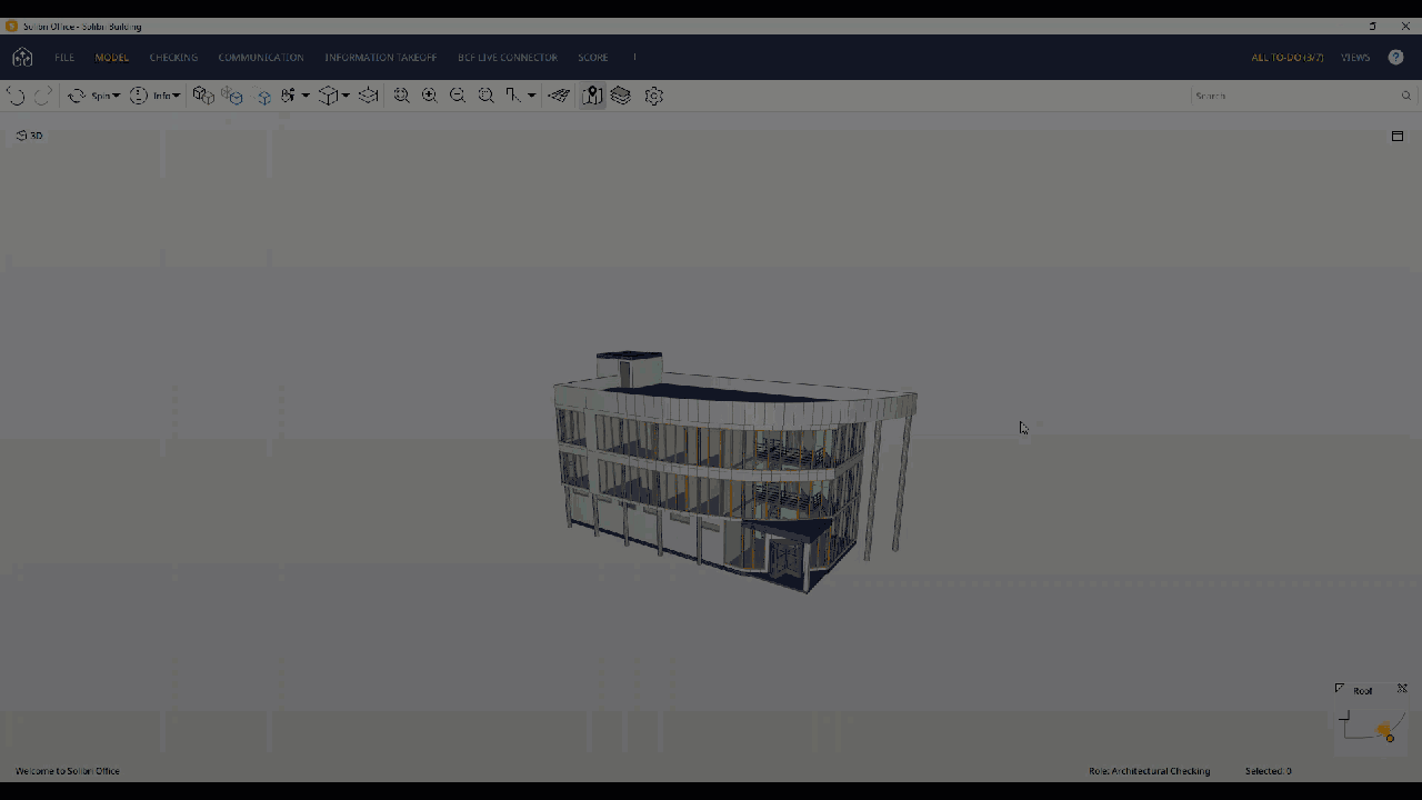

You can Spin the building around any point, including the center point of the model. You can spin the model into any direction. However, you can't spin the building upside down. The keyboard shortcut for Spin mode is 2.
If you have Spin as the default setting, left-click the mouse click drag to spin.
Tip
You can control the center around which the spin occurs by placing the cursor over a component before carrying out the command. If the point is left in space, the model will spin around the previous point.
