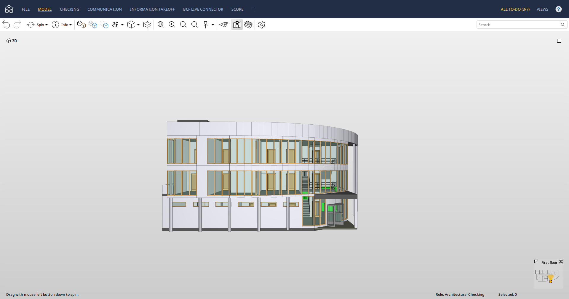

To change the projection, use the Camera Projections tool in the main toolbar:
To view the actual 3D representation of the model, select the perspective view (

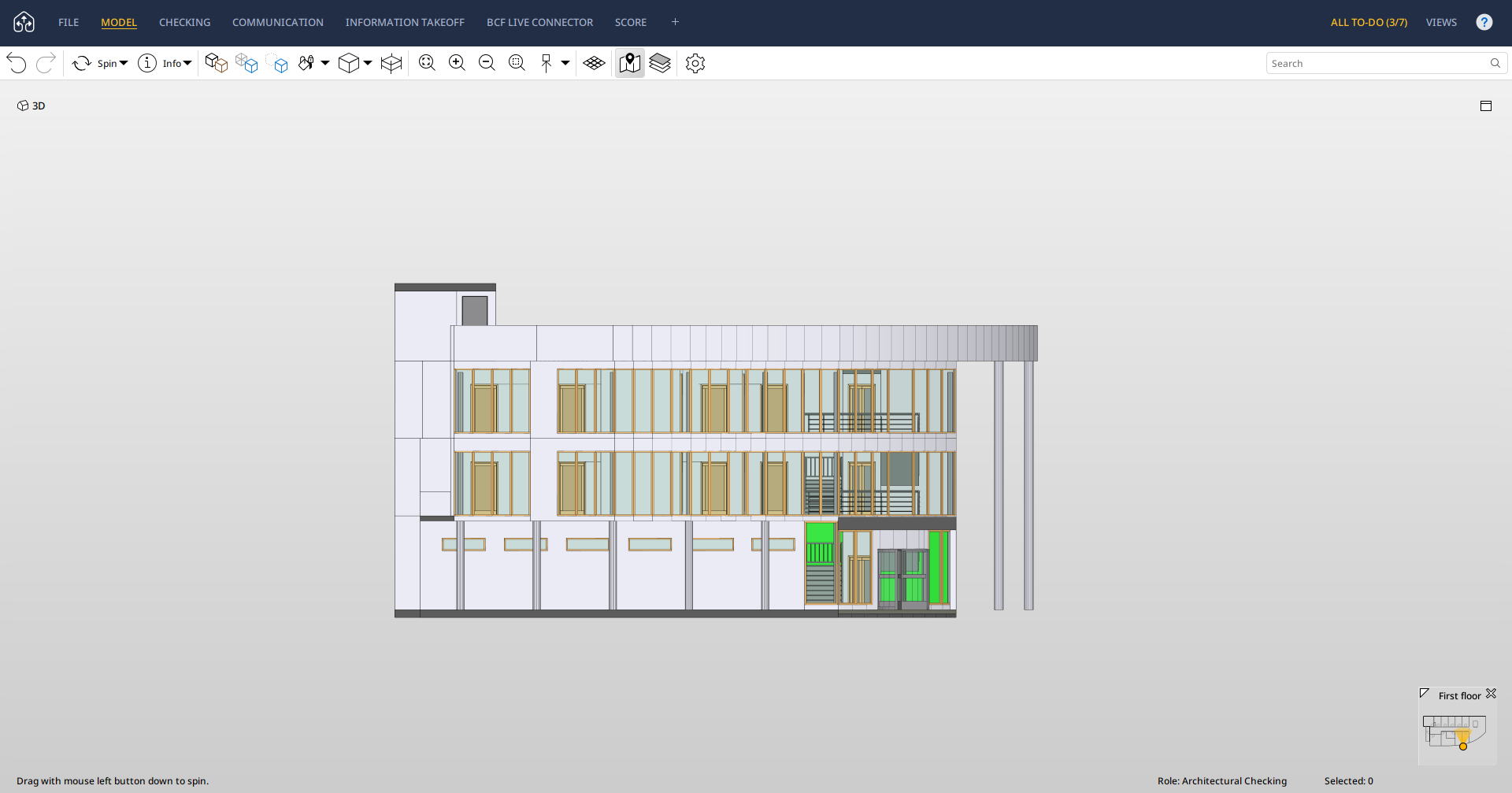

To view a 2D representation of the 3D model, select the orthogonal view (
