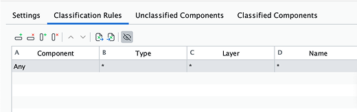

Classification columns are labelled with letters (A, B, C, etc.) to help identify columns when writing formulas.

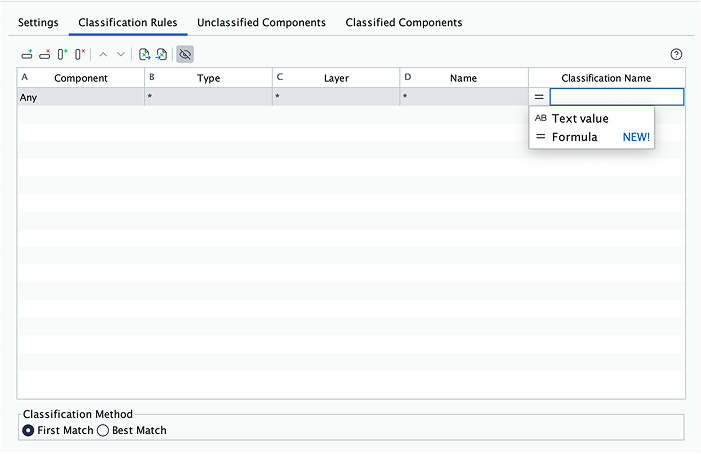

Formulas in Classifications allow dynamic values instead of static text. In Classification Name, users can choose between:
Text Value - this is the default option and the text is entered manually
Formula - this is a new option for dynamic values
The formula field always starts with an equals sign (=), which cannot be removed or edited.
As you type, auto-suggestions appear, filtering available column names and suggesting supported functions.
When selecting a function, it is inserted with parentheses, and the cursor is placed inside the first parenthesis for easy input.
When a new column is added it will be positioned to the left of an existing column.
This might shift the lettering of existing columns (e.g., what was previously "B" may become "C").
However, formulas automatically adjust and retain references to the correct columns.
This also applies when reordering columns—formulas remain intact despite changes in column positions
