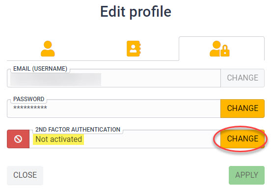

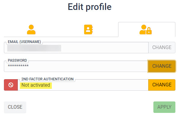

You'll land on the Edit profile page. On the Login tab, you can see that the 2nd factor authentication is not activated. To activate, click Change:

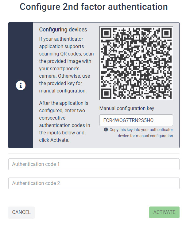

Configure the 2nd factor authentication.

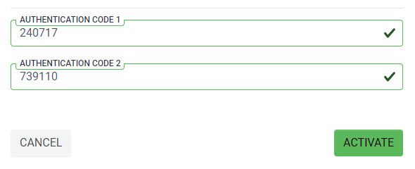

After the application is configured, enter two consecutive authentication codes from the application in the input fields and click Activate:

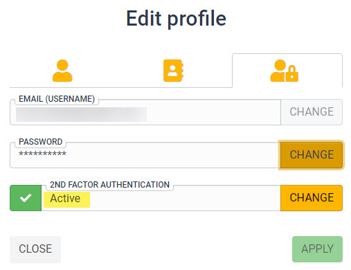

When the activation is ready, you're directed back to your profile page. The 2nd factor authentication should be active now:

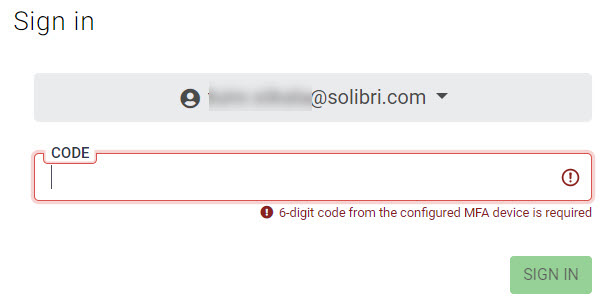

When you have activated MFA and wish to sign into, for example Solibri software or Solibri Center, you need to provide the MFA code:

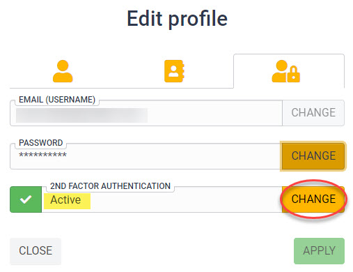

The 2nd factor authentication is now active. To deactivate it, click Change:

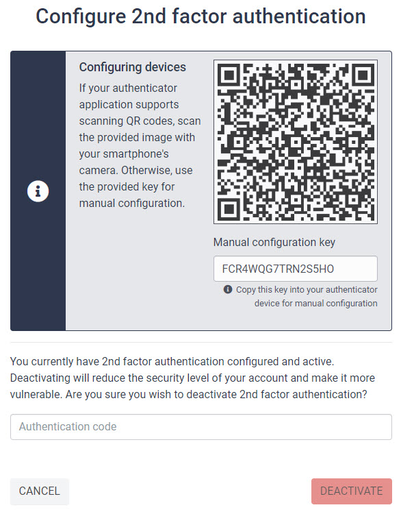

Enter the code from the authentication application and click Deactivate:
