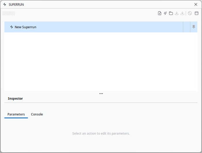

Open the Superrun view in Solibri.
Select New Superrun.

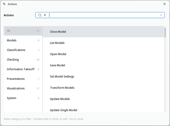

Select Add action to open the Actions dialog.
Choose an Action or use search, then double-click an action (or press Enter) to add it.

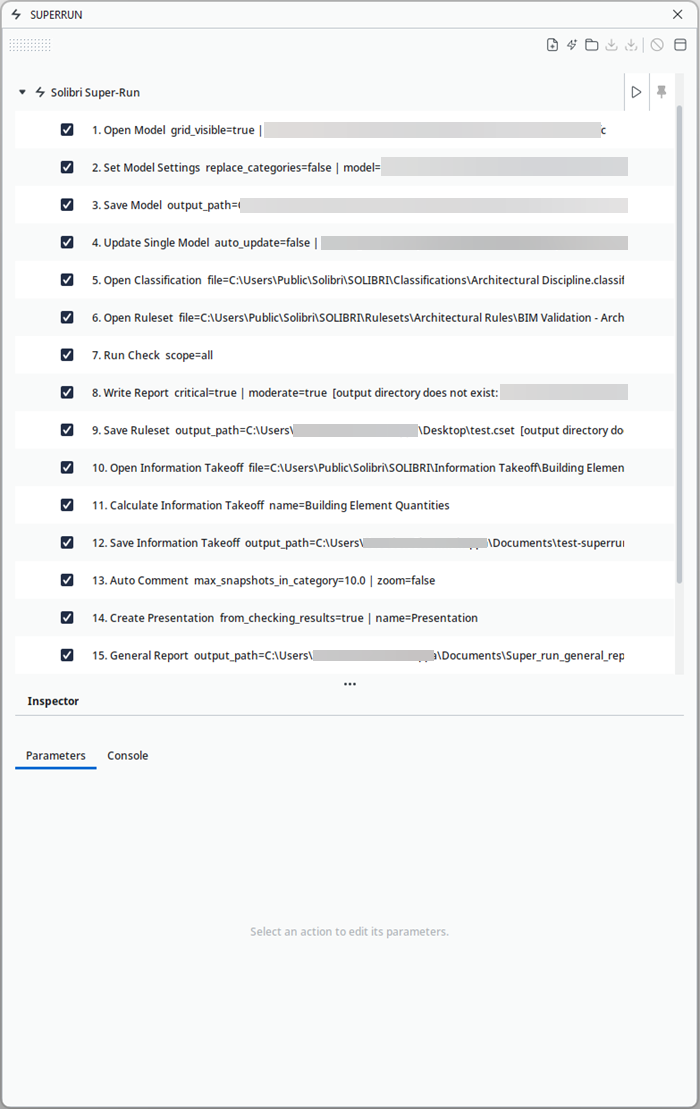

A Superrun can include actions for common Solibri tasks, such as:
Opening, updating, and saving models
Opening rulesets and running checks
Working with classifications and Information Takeoff
Coloring, isolating, selecting, and measuring components
Changing the camera view and taking snapshots
Creating presentations
Exporting BCF and Excel reports
Closing Solibri
