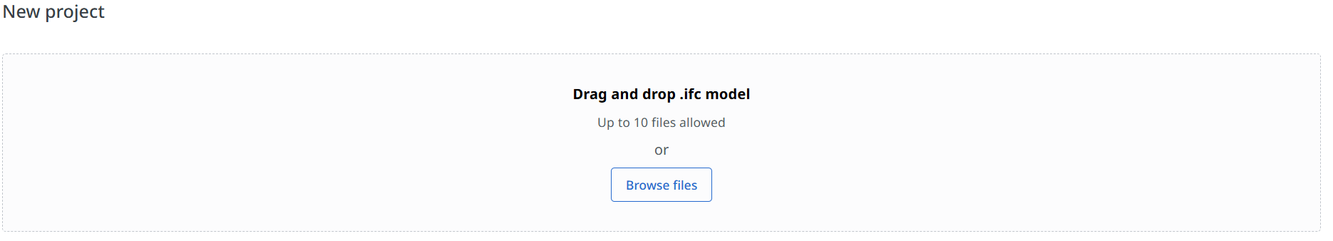

5.1 Creating a new project
Open Webchecker in your browser in the desired region or via Solibri Center (Products and Services)
Click New project.
Enter a Project Name.
Click Add files and select your IFC file(s) from your computer.
Confirm the upload.
Click Continue to create the project.

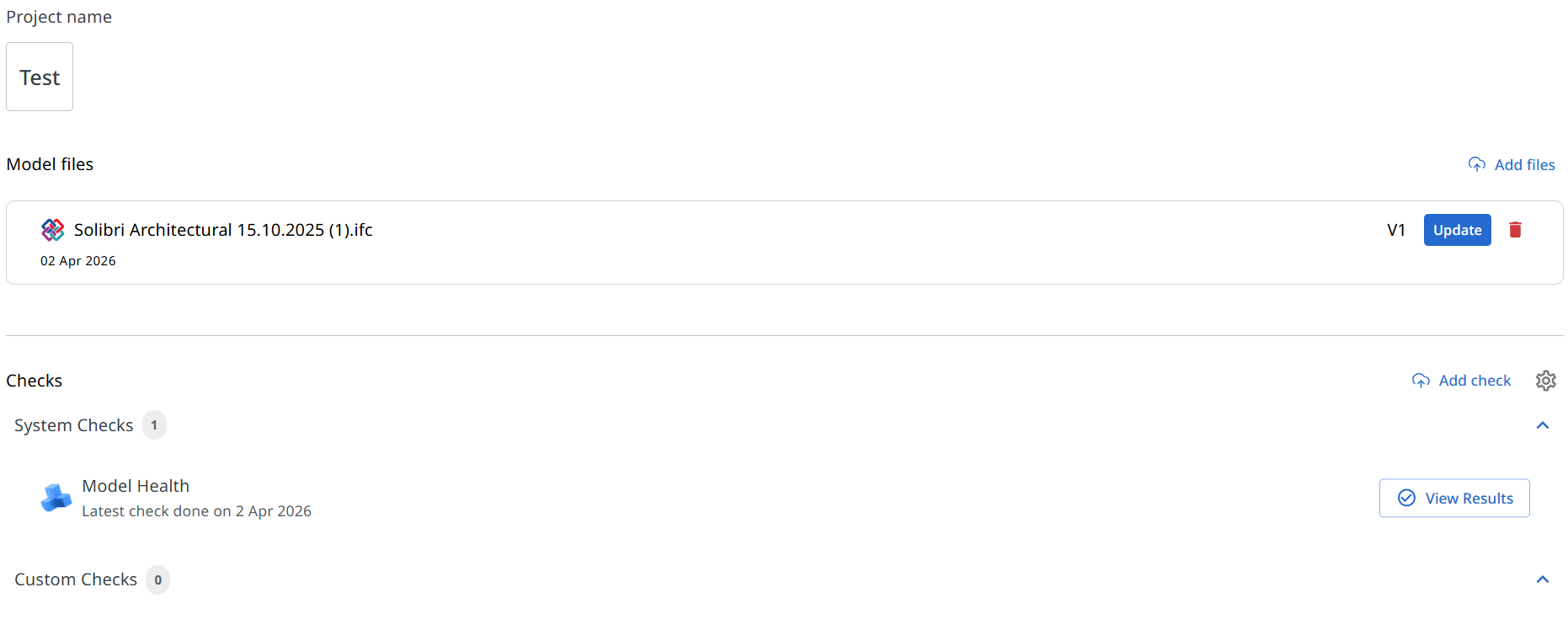

You will see the project overview page: project name, list of model files, and a section for Checks (system checks and custom checks).

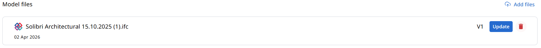

5.2 Updating model files
To replace or update an IFC file, click Update next to the model file and upload a new version.
Use versioning in your file names (for example, Project_Arch_V3.ifc) to keep track of which design revision was checked.

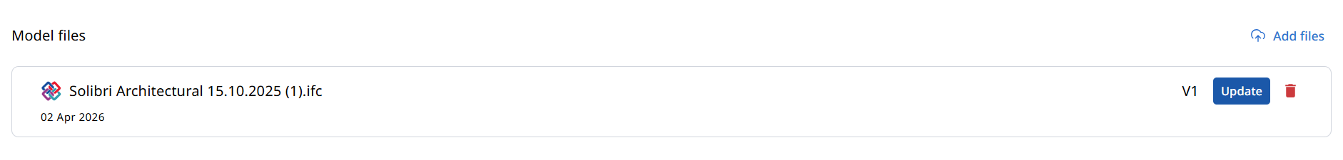

5.3 Deleting model files or projects
To remove a model from a project, click the trash icon next to the file.

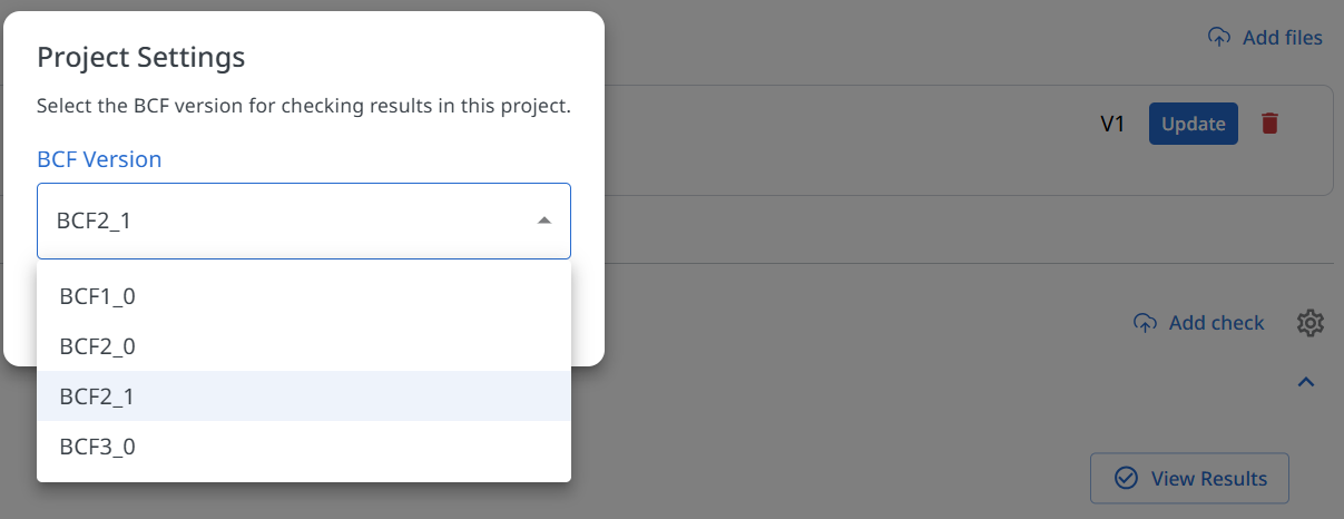

The BCF Version dropdown appears.
6.2 Selecting the BCF version
Supported BCF versions:
BCF 1.0
BCF 2.0
BCF 2.1
BCF 3.0
Open the BCF Version dropdown.
Select the version your CDE or issue-management platform supports.
Click Update to save the setting.
This setting controls the version used for all BCF exports for that project.

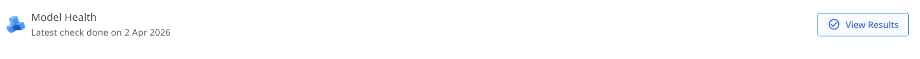

7.2 Running the Model Health check
Open the project that contains your model.
Under System Checks, locate Model Health.
Click Start to run the check.
The check is queued and executed in the cloud. Processing time depends on:
Model size.
Number of rules in the ruleset.
Current system load.
Once checking is complete, the status changes and you can open the results.

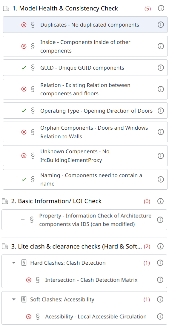

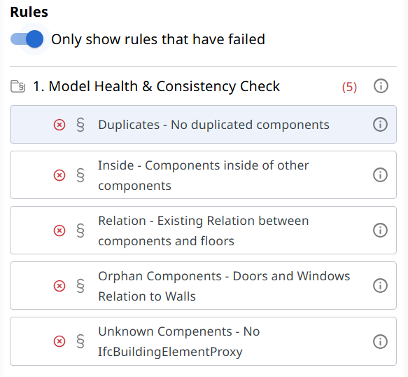

9.1 Rules and rule status
On the left side, you see the rule hierarchy:
Chapters and groups (for example, “Chapter 5 – Sanitary Provision”).
Individual rules (for example, “Accessible Individual Washroom Internal Dimension”).
Icons indicate the status for each rule:
Passed.
Failed.
Not relevant / not checked.
You can filter results to only show failed rules to focus on issues.

Designers upload architecture IFCs to Webchecker early in the design phase.
Run the Model Health check to:
Detect missing IDs and names.
Ensure key information such as fire ratings and IsExternal are present.
Get an overview of geometric clashes between disciplines.
