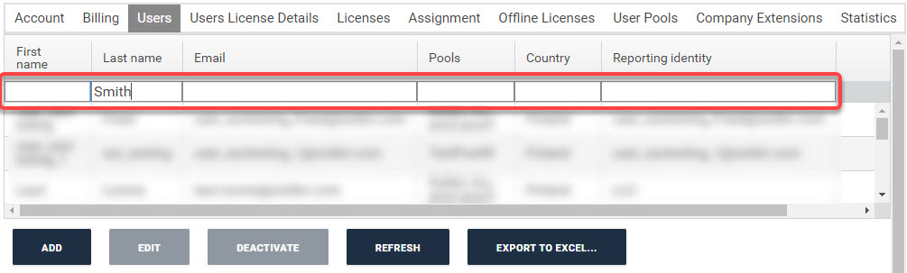

By filtering, you can search for a specific user or for example all the users in a specific user pool To filter the list of users, type the text into a cell on the first row and press Enter:
