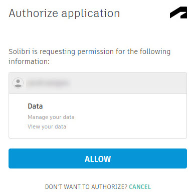

A browser page opens, and you need to authenticate the access by clicking Allow:
When the authentication is successful, you can close the browser.

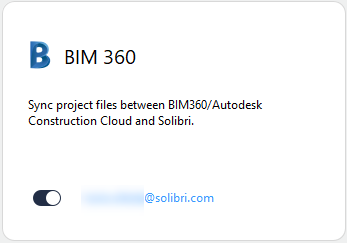

Once authenticated, the BIM 360 integration will display your username:
Tip

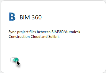

To end the connection, switch off the toggle.

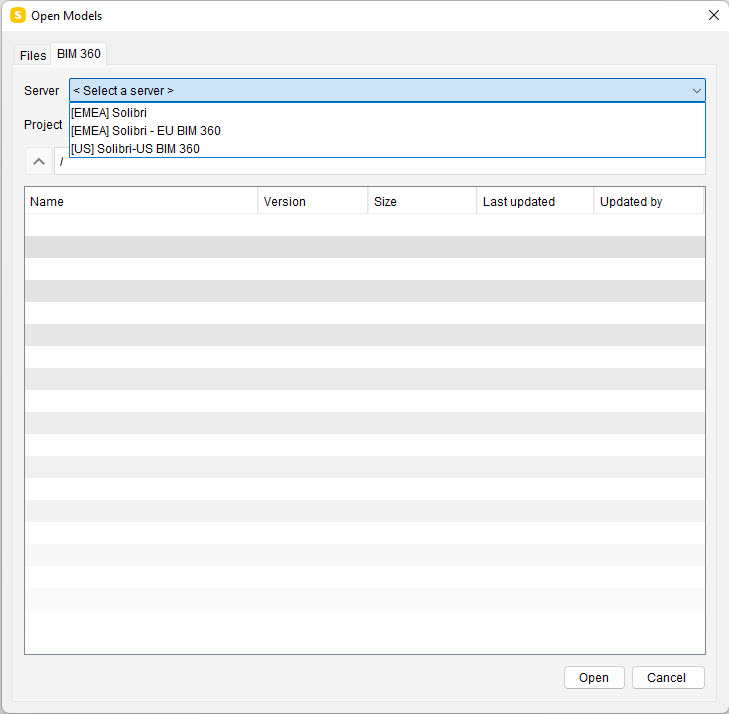

Click File > Open Models. A dialog opens. Select the BIM 360 tab.
Select the server (EMEA/US) from the Server drop-down menu:

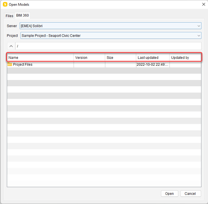

Select your project from the Project drop-down menu:
After selecting the project, navigate to the desired file or folder below.
In the file chooser, you can see the different files and sort them by Name, Version, Size, Last updated and Updated by by clicking the column heading:

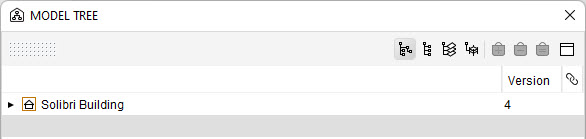

When you open a file from BIM 360, you can see the file version number in the Model Tree view:

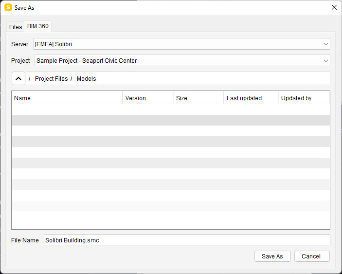

You can only save SMC files into BIM 360. To save models into BIM 360:
Click Save (if saving for the first time) or Save As. A dialog opens. Go to the BIM 360 tab.
If you have opened the file from BIM 360, the file chooser remembers the project. If not, first select the server and project and then navigate to the correct file location:
Select the file location and click Save or Save As.

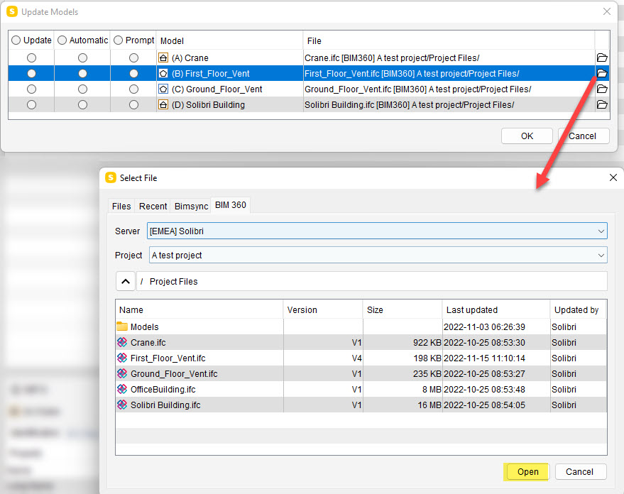

You can update imported IFC models with new versions directly from BIM 360. You can select to update either a single IFC model or several IFC models at once.
Note that if you update models, you need to manually re-check the model to update the checking results. Issues that are not affected by the update keep their decisions, comments and snapshots. You can see the updated model in 3D when an issue is selected. You need to update the snapshots and other details in issue slides manually.
To update models from BIM 360:
Select a model/models in the Model Tree view. Right click and select Update Models from the context menu:
Alternatively, click File, then Update Models. The dialog below will then list all the opened models and you can select which ones you wish to update.

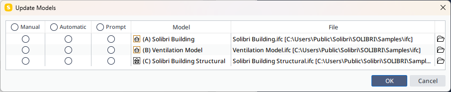

The Update Models dialog opens:
Select one of the three updating options:
Update: Requires you to manually carry out this task when you want to update any models. If the filename has changed (revision letter, date etc.) then the new version of the file will need to be located using the Folder icon (
) at the end of the row. This will need to be done for each model.
Automatic: Updates are done automatically in the background when the software is started, and during a session if the time stamp is changed. Make sure that the new version of your file(s) is located in the same folder where the original model file is, and that it has the same name. The software will update your model automatically.
Prompt: You will get a prompt when the update is available, and the updating starts at your convenience. Make sure that the new version of your file(s) is located in the same folder where the original model file is, and that it has the same name.
When you click
, the File Chooser dialog opens. On the BIM360 tab, go to the correct file location, select the file and click Open:
Click OK.
